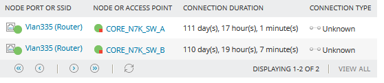

I can't UDT to show the access port a device/MAC is connected to. I had it working when I first set it up awhile ago but no longer working when I search a MAC. I just get the core Nexus the access switch is connected to.
The access port, VLAN, and trunk on the access switch is monitored.
The trunk and VLAN on the Nexus 7K is monitored.
I have added the SNMP context configs below.
