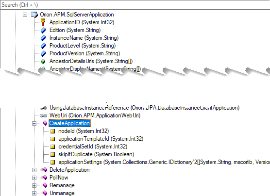

I have been working on a script to assign AppInsight for SQL to nodes using the API. There was a great starter script on the GitHub but I'm running into a strange issue. When running the script I'm getting it to fully execute but it will only execute with a result of -1 regardless of setting the duplication flag as true or false. Nothing shows up in the SWIS logs nor the APM businesslayer logs to help me investigate this. I was even trying to change up how some of the script was putting the info together just in case it was a weird formatting bug but I've not come to any conclusions on that. Where should I look next?

$applicationId = (Invoke-SwisVerb $swis "Orion.APM.Application" "CreateApplication" @(
$nodeId,
$applicationTemplateId,
$credentialSetId,
"true",
$appSettings
)).InnerText

if ($applicationId -eq -1) {
Write-Host "Application wasn't created. Likely the template is already assigned to node and the skipping of duplications are set to 'true'."
