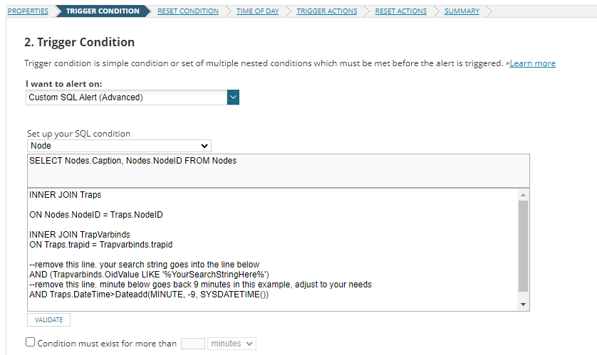

We are on version 2020.2.6 but never upgraded our Log Viewer so still using the original version that you need to run from the Orion Server via an RDP session. We had the need to create a complex alert condition: if Node A is down and Node B is down and a specific SNMP Trap was received the alert would trigger.
This all requires the use of the Advanced Alerting Engine. In order to do so the node up/down alerts were created in the normal manner but the SNMP Trap portion of the alert needed to be done via an advanced SQL Query. Below is a screenshot of the query. Hope this helps if anyone else runs into a situation where you need to use SNMP Traps with the Advanced Alerting Engine.
Here is the cut/paste friendly part:
INNER JOIN Traps
ON Nodes.NodeID = Traps.NodeID
INNER JOIN TrapVarbinds
ON Traps.trapid = Trapvarbinds.trapid
--remove this line. your search string goes into the line below
AND (Trapvarbinds.OidValue LIKE '%YourSearchStringHere%')
--remove this line. minute below goes back 9 minutes in this example, adjust to your needs
AND Traps.DateTime>Dateadd(MINUTE, -9, SYSDATETIME())
