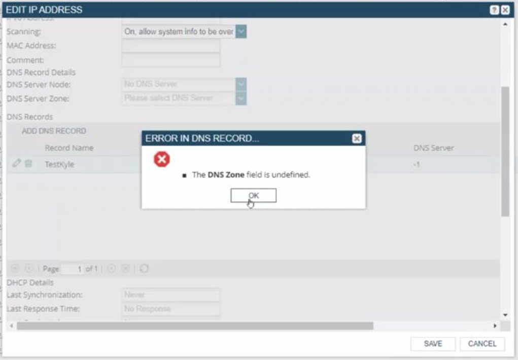

The client was having the below error.
The client was new to the IPAM module and was not sure about the current configuration.

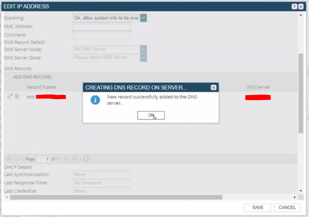

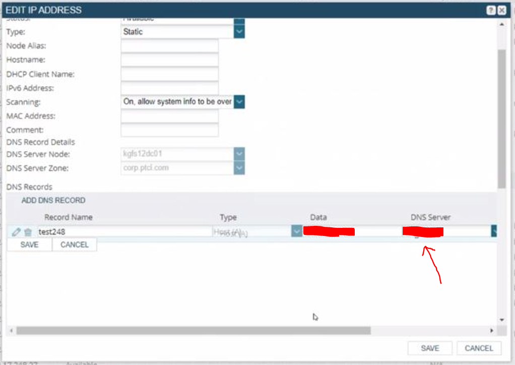

So, I guided the client to check and verify the Primary DNS Server of his environment.
After selecting the correct DNS Zone only, the client could successfully add the Host A records to his DNS server. ( Another HAPPY Client! )
DNS is always critical because DNS is the backbone of any Network.
So, always make sure to select the correct Primary DNS Zone for IPAM when you are creating Host A records.
