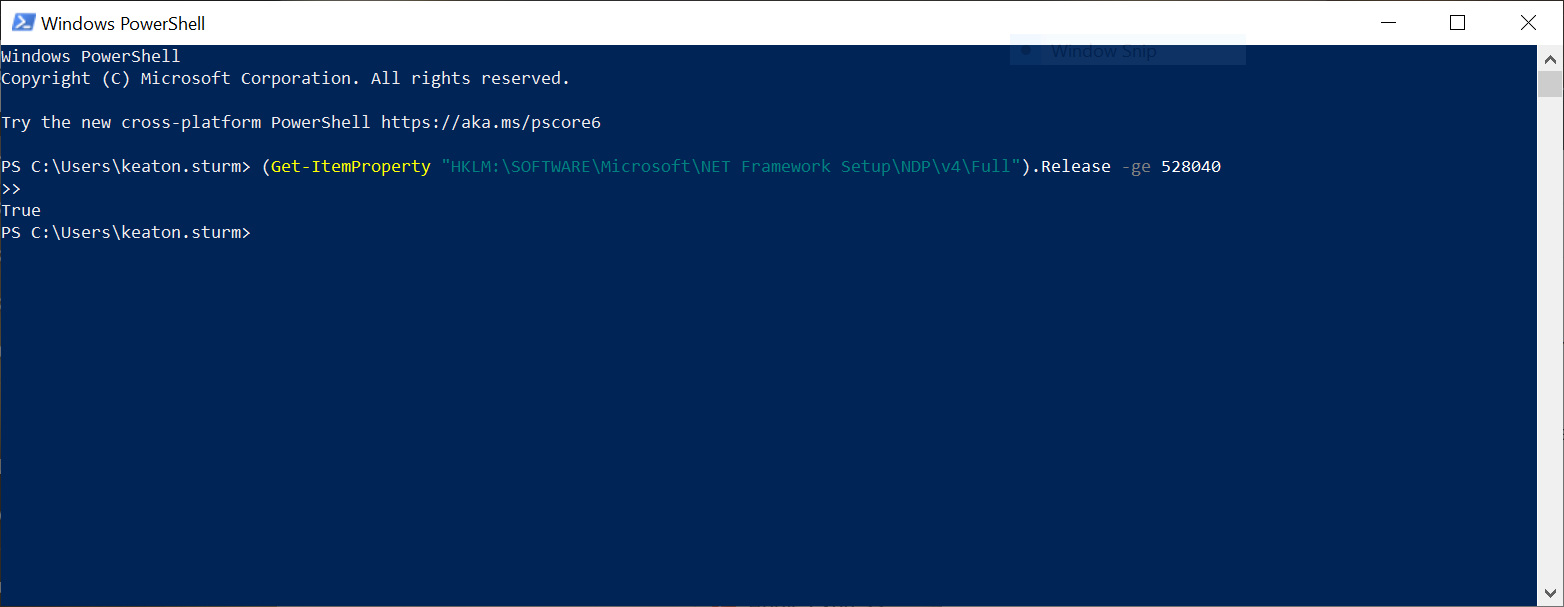

I do, however, have .NET 4.8 installed on my computer and I've verified with PowerShell. You can see the attached screenshot.
How can I get this install to recognize that I have 4.8?
