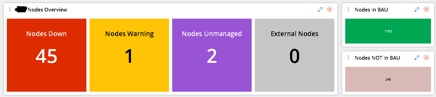

My (current) Answer: So I have recently got in to modern dashboards, and see this as a fantastic approach to re-creating the built-in Top 10 but is client specific. And the opening view is this:
I see this as a reasonable response to their "log everything" request and my "No" response. They can, at a glance see if they have a flood of node downs, etc. This can clearly be expanded on to include other info such as interface downs, nodes in maintenance, nodes muted, etc
