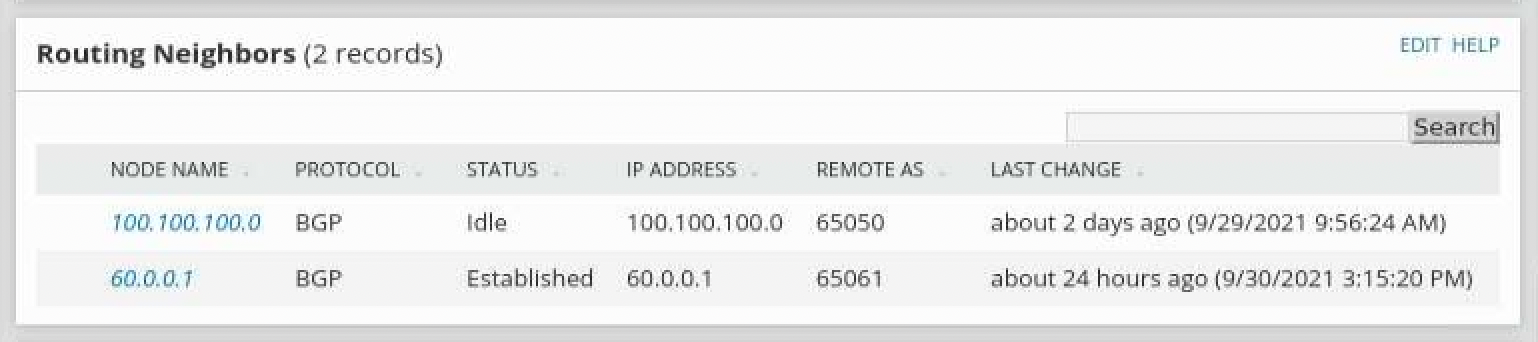

Is there a definition anywhere of what information should be populated in this description? Where would you find this in the GUI? I've only seen this referenced in the API. Under Network I see this, but there is no description field.
