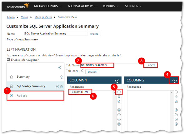

In the Orion Web Console, navigate to the Applications → SQL Server view.
From the left navigation select Customize Page → Page Settings
- Choose Add Tab.
- Name the tab whatever you like, I called mine SQL Sentry Summary.
- Click the Update button to save the name.
- Remove Column 2 & 3 (if applicable)
- Click Add
- Search for “Custom Html Resource” and add it to Column 1.

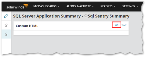

After saving, Edit the Custom HTML Resource...
