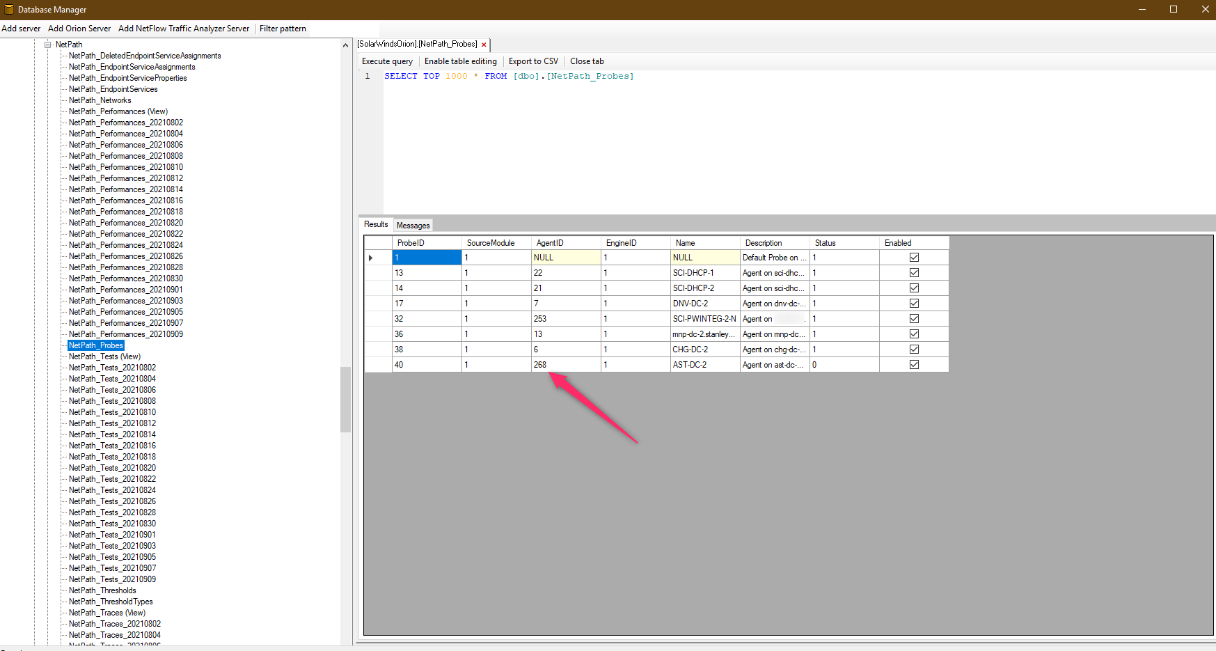

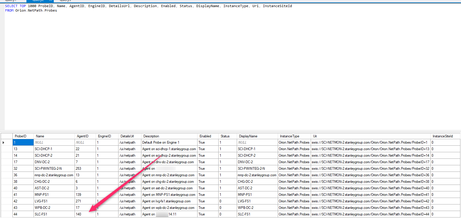

When the new probe is created it is put into the NetPath_Probes table. In that table the cross reference is made to the AgentID. Here you see AST-DC-2 is referred to as 268. Well, this seemed odd to me [yes, I have a fairly small number of agents I monitor]. I went and checked the Agent table.
NetPath_Probes table query and results

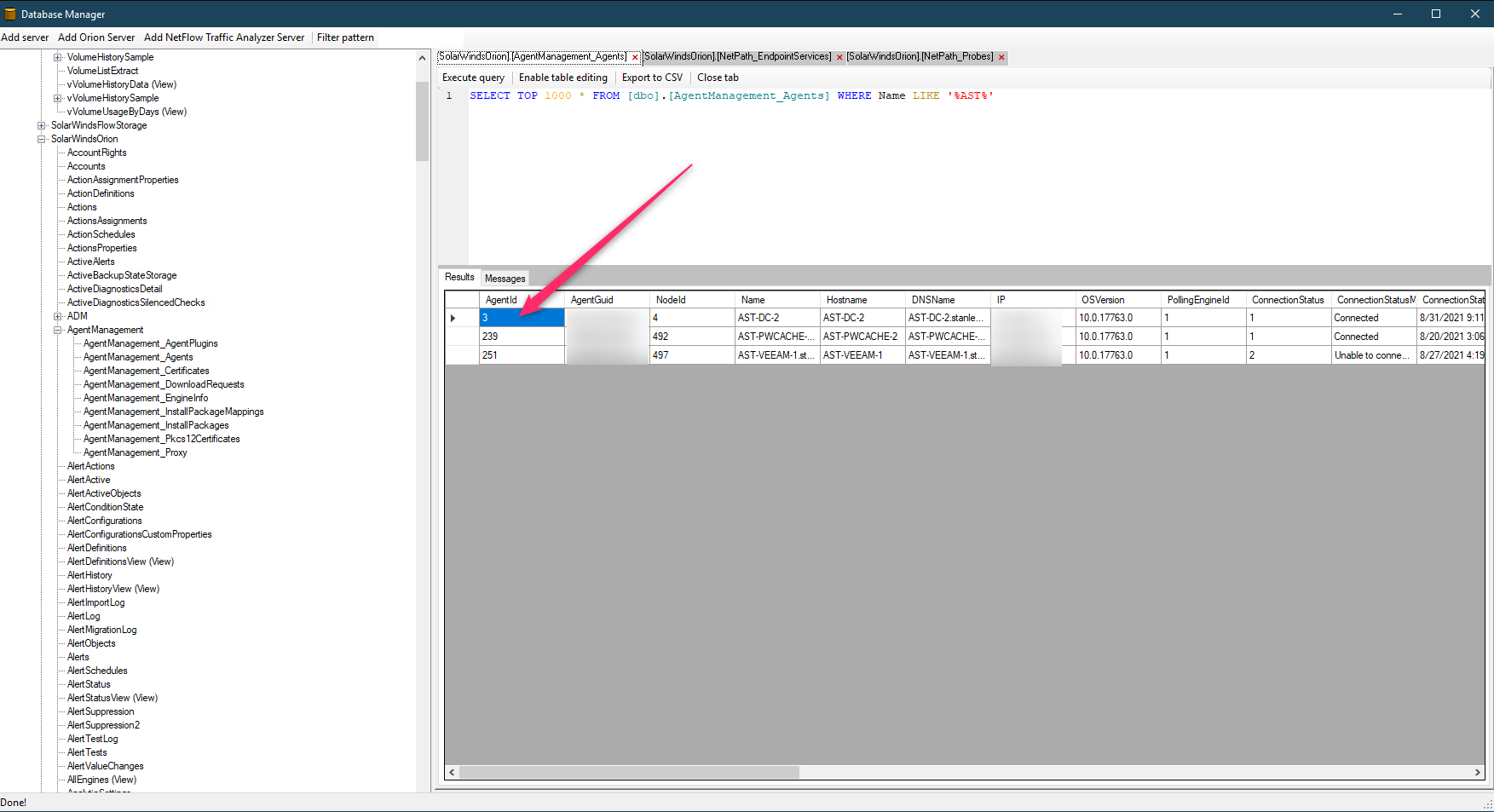

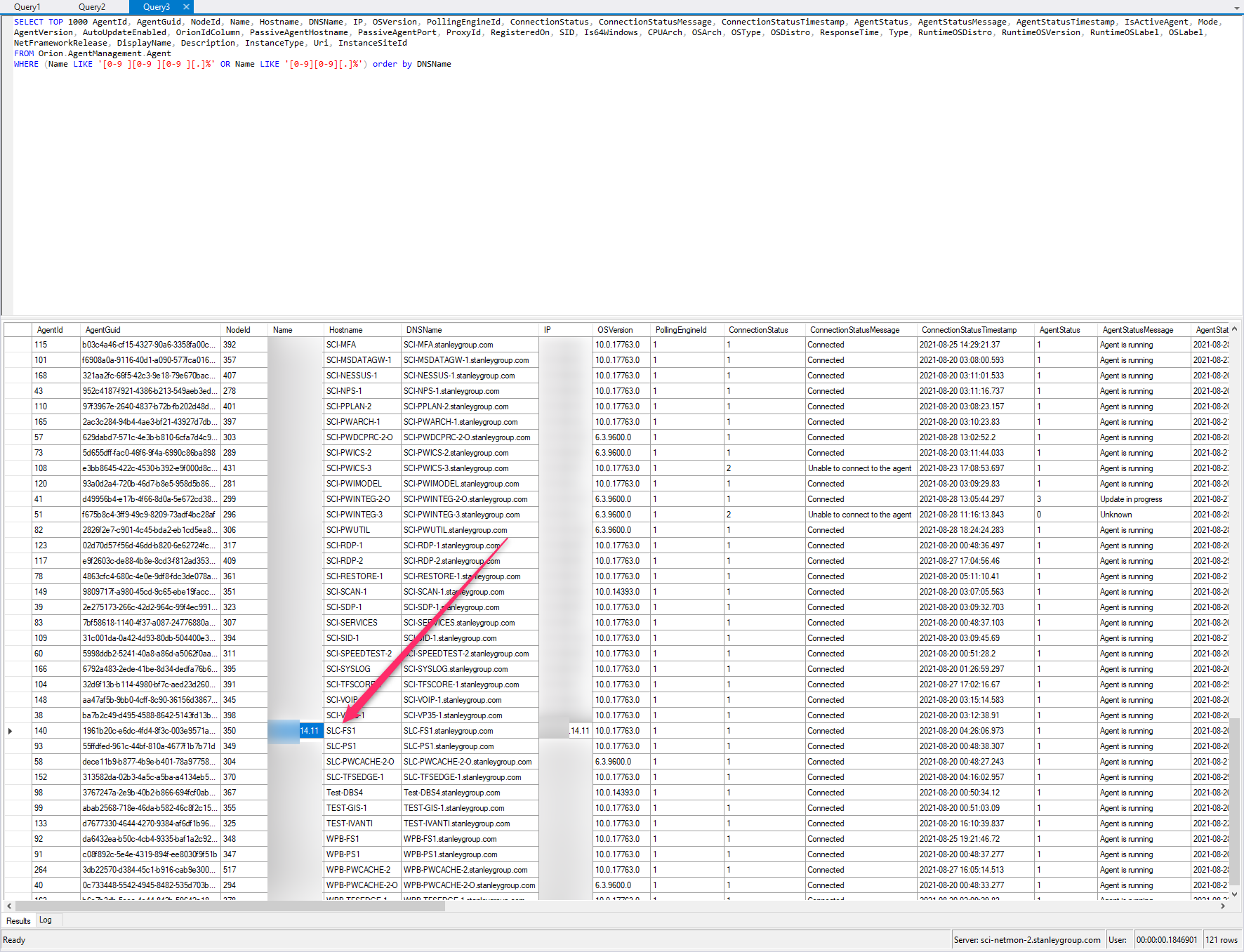

The query from the AgentManagement.Agents table shows the AgentID is 3, not 268
AgentManagement.Agents table query and results

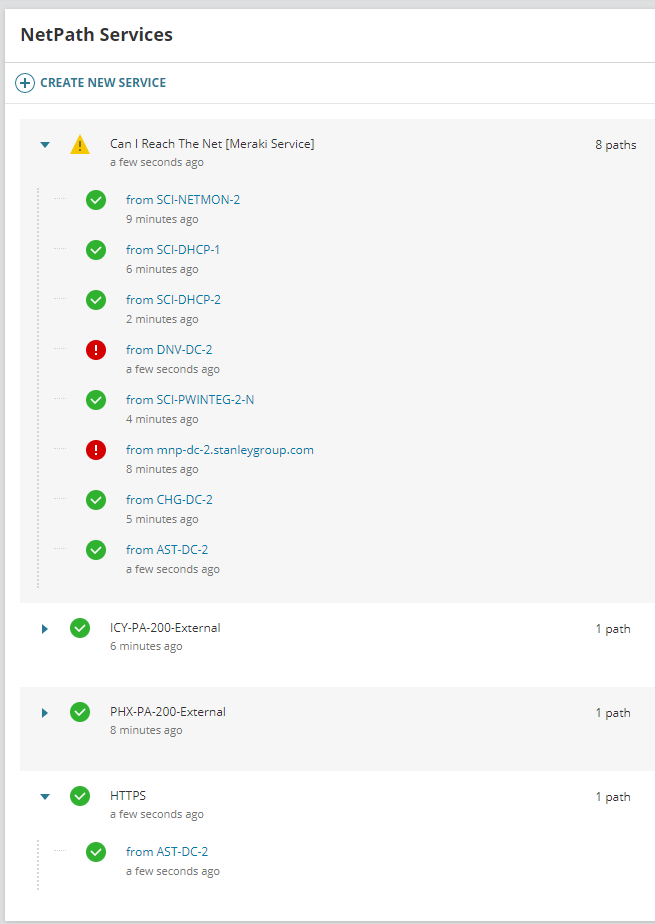

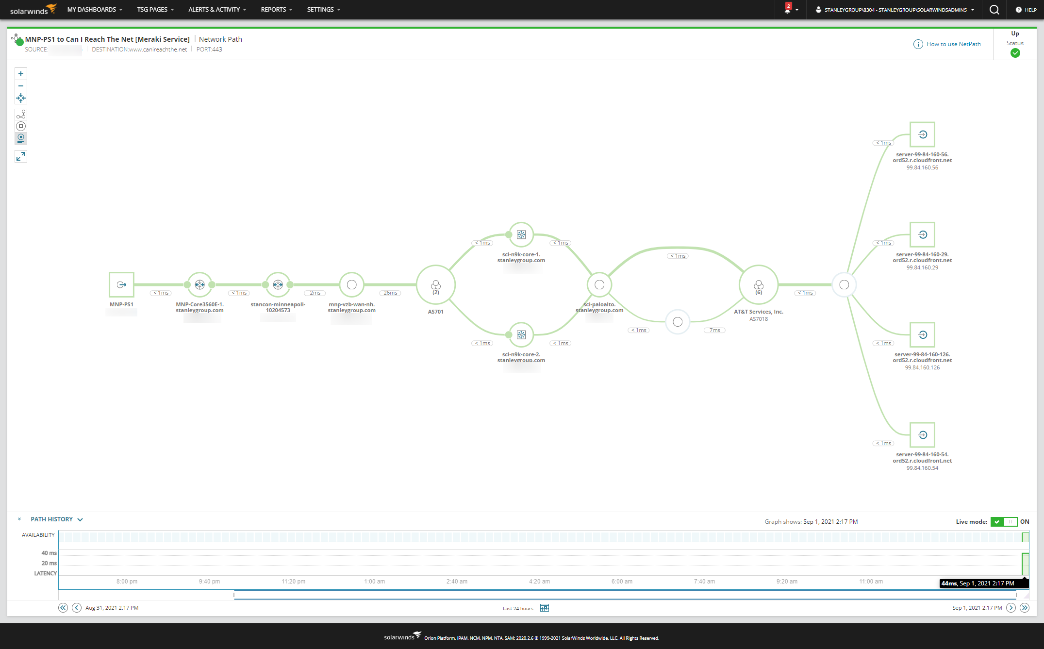

I updated the NetPath_Probes table so the AgentID match that in AgentManagement.Agents. Then restarted the Agent on the AST-DC-2. Checking the PLUGINS directory on that server showed that the NetPath plugin files were now installed. Prior to this they were not there. I went into the NetPath services in Orion, removed the broken Probe from the Service, and added two new services using the AST-DC-2 probe. As you can see they are now both working.
AST-DC-2 probes show the service paths are being monitored.

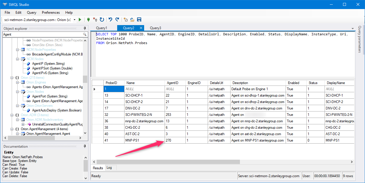

I was able to repeat the process on one of the other servers we were having trouble with – MNP-PS1.

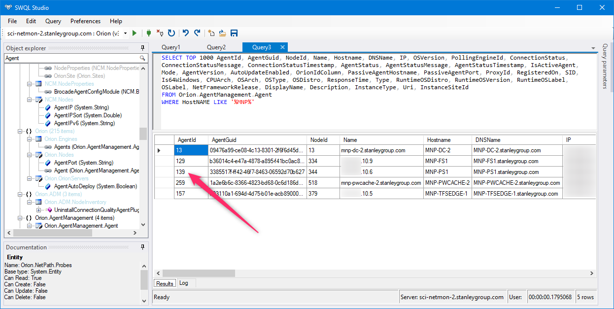

Looking in the Agent table with SWQL this time to get the correct reference for the Agent ID.

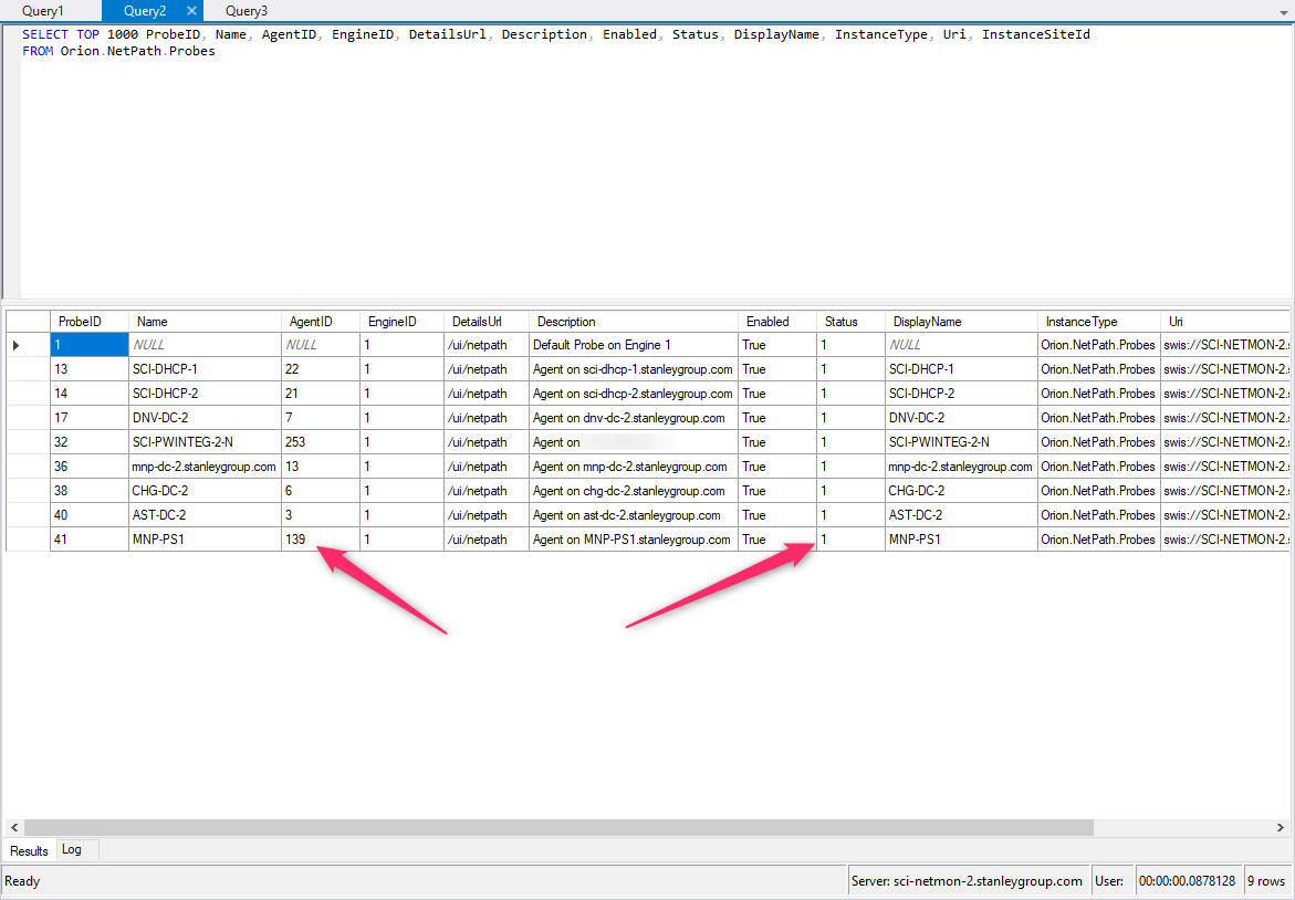

Showing the updated entry through SWQL query. I used the Database Manager to edit the table entry to correct this record.
Then I restarted the agent services on the probe and the path is now being monitored.

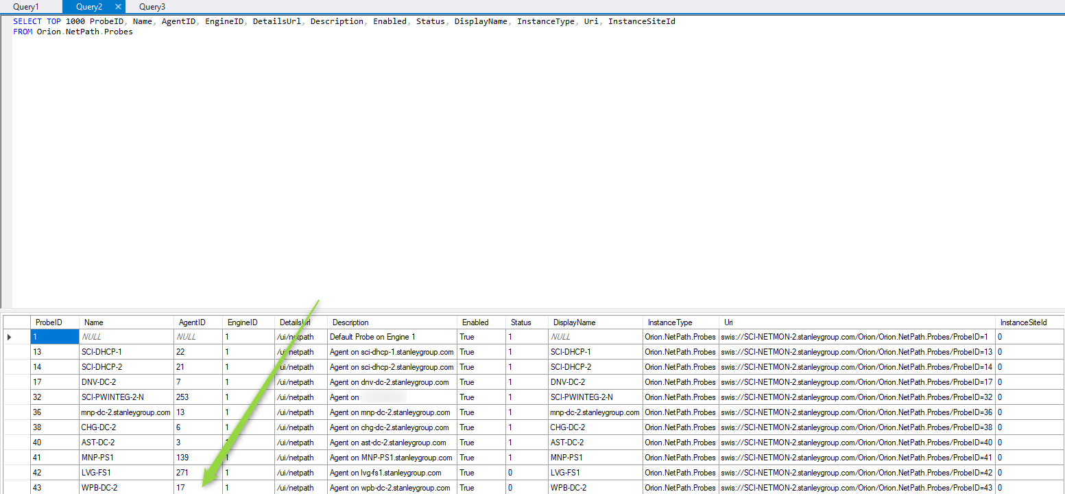

Makes me wonder if there is something wrong with the Probe creation process. Digging further I find when the agent NAME is an IP address, and trying to add the probe using the name, it doesn’t match an AGENTID. Tested this with the LVG-FS1 server. If the host name of the probe is used that matches the agent’s name then it works ok. See WPB-DC-2.
Next, I tried to add the Probe using the IP address instead of the HOST name to see if at least the PROBE table would pick up the correct AgentID. I did this on SLC-FS1, after a query of the AgentManangement.Agents table. Sure enough the NETPath_Probes table was updated appropriately.
NetPath_Probes table query and results showing LVG-FS1 and WPB-DC-2.

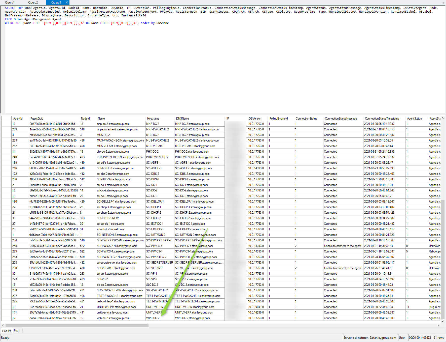

Query from the AgentManagement.Agents table where Agent Name is not like an IP address.
Query from the AgentManagement.Agents table where Agent Name is like an IP address.

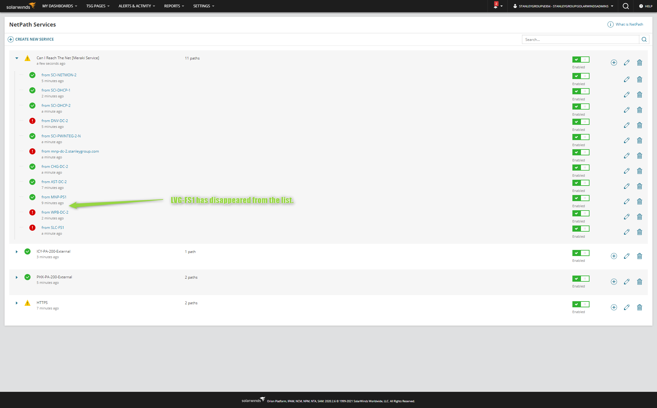

I can see that the NETPATH plugins were added to SLC-FS1 just fine. However, as I have noted previously, they do not appear to even get installed on LVG-FS1 as it has the wrong AgentID in the NetPath_Probes table. Notice that the LVG-FS1 probe persists in the table even though it no longer appears in the NetPath page.
LVG-FS1 probe is not longer showing up.
