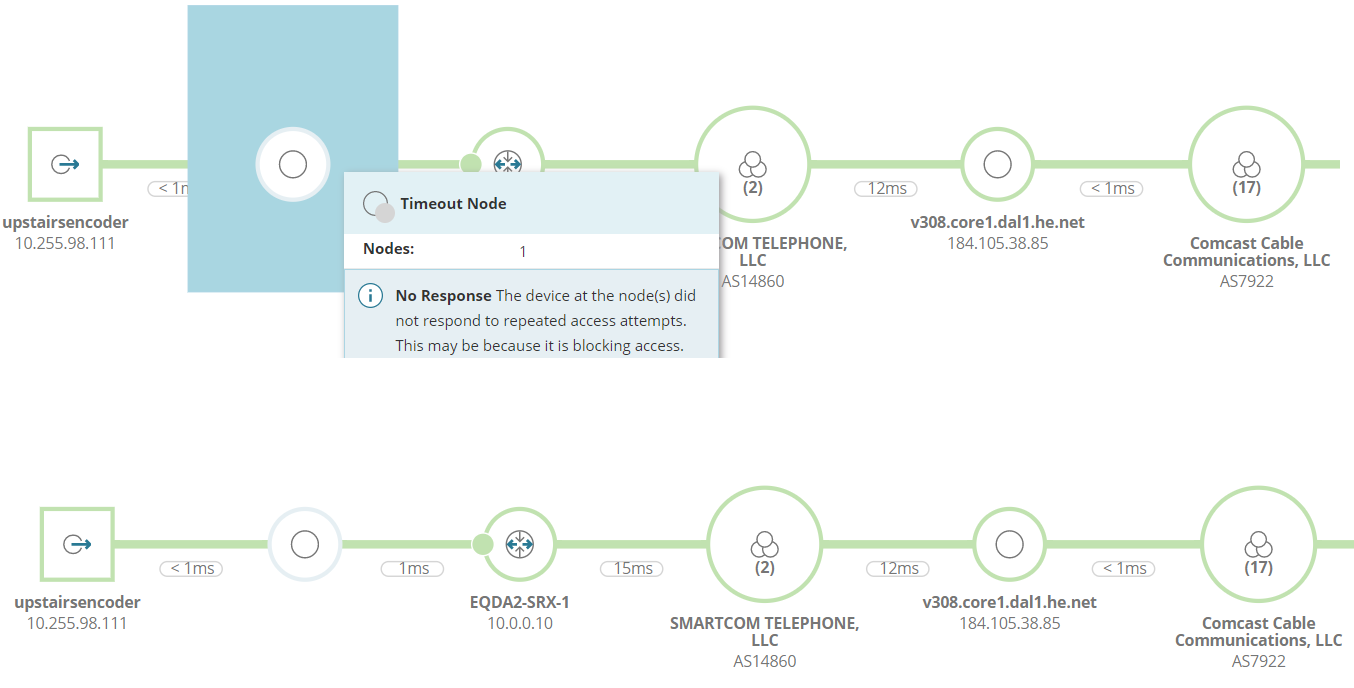

When doing any netpath i'm noticed that my internal core router is being excluded from the netpath topology. The first two hops are both SNMP devices in my network and monitored in NPM yet only the 2nd one shows up in netpath.
Getting a Timeout Node "No Response The device at the node(s) did not respond to repeated access attempts. This may be due to it blocking access"
1 <1 ms <1 ms <1 ms gateway.mercurynetworks.net [10.255.96.1]
2 <1 ms <1 ms <1 ms eqx-srx-level3.mercurynetworks.net [10.0.0.10]
