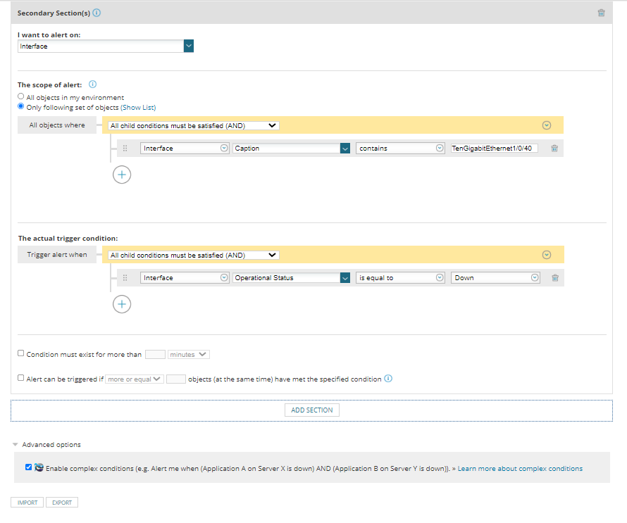

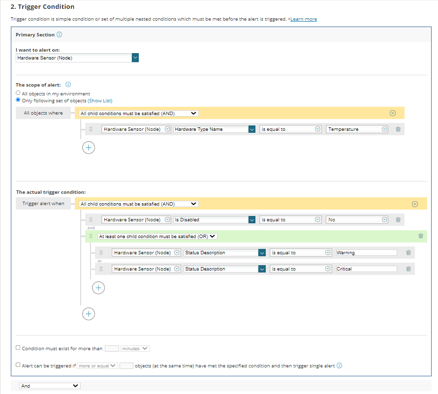

I've created the following test alert using complex conditions, but the alert is created even when the first section matches an event on node A and the second section matches an event on node B. Both should be on the same node.
Note: I'm not tied to a complex condition as a solution to this. I'm open to using groups, SQL/SWQL queries, etc. to accomplish it.
