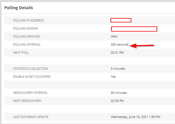

On the node details page I can see the "Polling Details" section says the "Polling Interval" is 300 seconds
Is that the frequency at which the polling engine will check the node status?

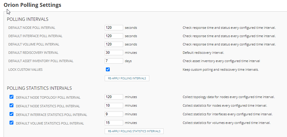

If I go to Polling settings I see this:
Does this mean that the poll intervial is 120 seconds for every node? Why does this differ from the polling interval on the node details page? Or maybe this is a global polling interval default, and this it mean that for newly created nodes the poll interval will be 120 seconds?
Note: I've tried clicking "re-apply polling intervals" on the above admin page thinking it would change the poll interval for each node, but when I go to the node details page the poll interval remains at 120 seconds. (I've tried to follow the instructions here: https://documentation.solarwinds.com/en/success_center/orionplatform/content/core-polling-intervals-sw1826.htm , but as mentioned, after clicking the re-apply polling intervals button, I see no change to the polling interval on the node details page)
Thus, it isn't clear to me how often my nodes are being checked for their status. It feels like 300 seconds because that is what the node details page says?
