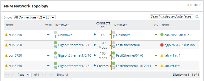

Orion Maps function as a visualization tool for the entire platform. Topology connections are derived from NPM. If you check a Details Page of a device you expect to see more connections present, select the Network tab and locate the NPM Network Topology Widget.
This widget will reflect what connections will be automatically drawn in Orion Maps. Orion Maps will visualize any connection where we understand and see the interface on either side. So unknows will not be present. Do you have an example you can share?

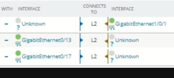

This Network Topology , i don't know why show unkonw interface
Maybe the reason for not show connect in orion map ?
That is exactly why they are not showing on the map. There is a way to force this, but it wouldn't add any value to the map, simply a grey line that states it is unknown. This typically means that the interface is not being monitored on the other side. Simply adding the interface would correct the issue. If you access the other device and select List Resources, make sure the corresponding interface is selected.
