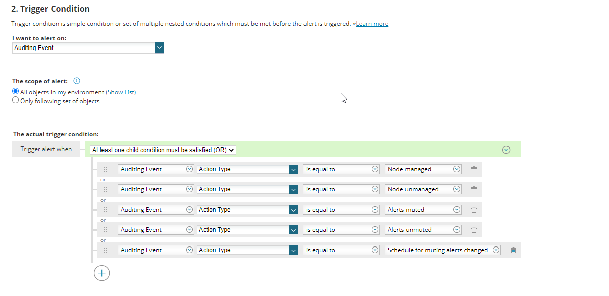

You can do this via the normal web alerts too. See image below, you may want to delete the unmanaged conditions. This works pretty well for me. The trigger action sends an email with the audit message. THe message includes who and what. Here is the variable string that I use:
${N=SwisEntity;M=AuditEventMessage} on ${N=Generic;M=DateTime;F=DateTime}
Trigger condition:

This worked perfectly! I tried the first suggestion but was having trouble with it firing the Alert consistently, this works everytime! thank you
