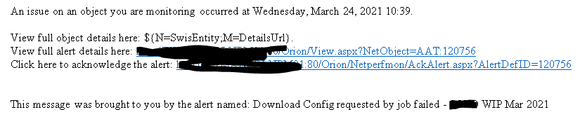

We are investigating this canned alert "Download Config requested by job failed" and have created a duplicate so we can play around with it The alert works and when the action is set to email then that also works, but the output is very limited / crude.
Now I know that the numbers at the end equal the Node ID but... we'd like to be able to include, amongst other aspects, the actual name of the node. Certainly that would help us when we turn this into an automated alert for raising an incident.

However, I can't see where it is extracting the NodeID from - if I load the above query into the SDK all I get back are entries like:
>> swis://NAME_of_Server/Orion/Cirrus.Audit/ID=B8C77171-5C94-4649-8391-0000CAA7BEE6
No names, no NodeID's that relate to the eMail output and so my
First question is how does that string of numbers/letters after the 'Audit/ID=' get translated to the output in the email? I guess I'm asking why I don't see in the SDK the info n the eMail?
