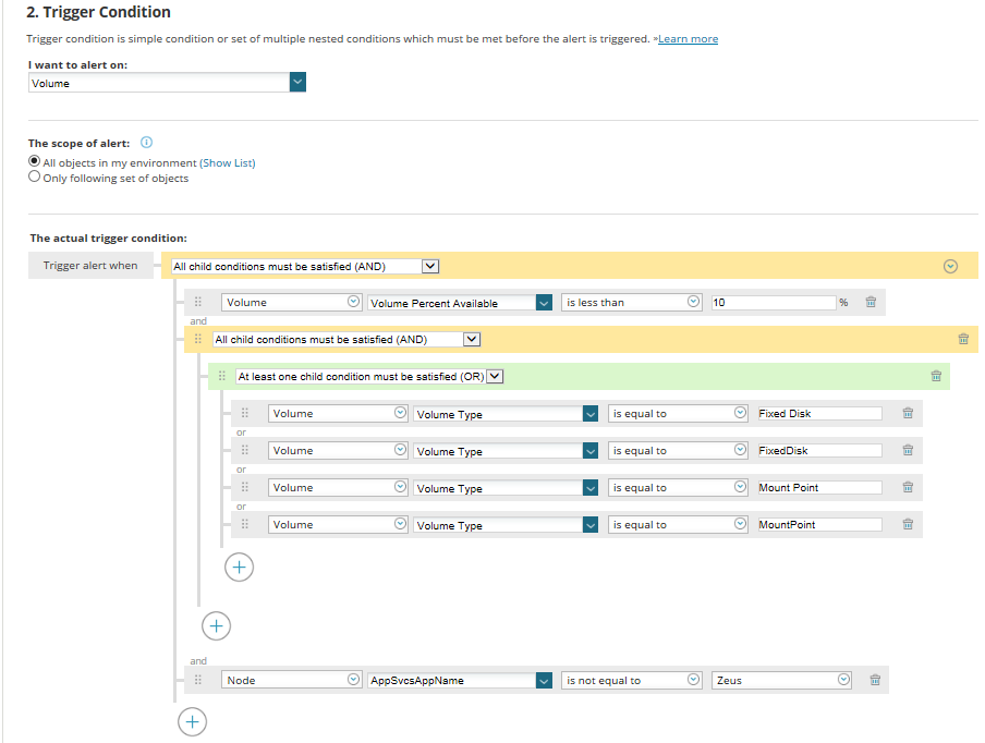

I have two types of volume alerts, one to alert on warning when available space is between 11 and 15%, and one to alert on critical when space is between 0 - 10%. Neither is triggering correctly. They're sending too frequently and the critical alert is sending alert for servers with 11 and 14% available.
I'm wondering what I'm going wrong here? I only want these alerts to send once every 12 hours unless newly triggered. I've pasted below what the trigger condition is for my critical alert since it's the one sending alerts on volumes with yes, less than 10% available but also with up to 15% of drive space available.
Also, what should my Evaluation Frequency of Alert be? I have it set to one minute because I want to make sure it picks up any urgent space issues that happen that could arise quickly and cause an outage but I only want repeat alerts on a server every 12 hours.
Any suggestions? Thank you in advance.
