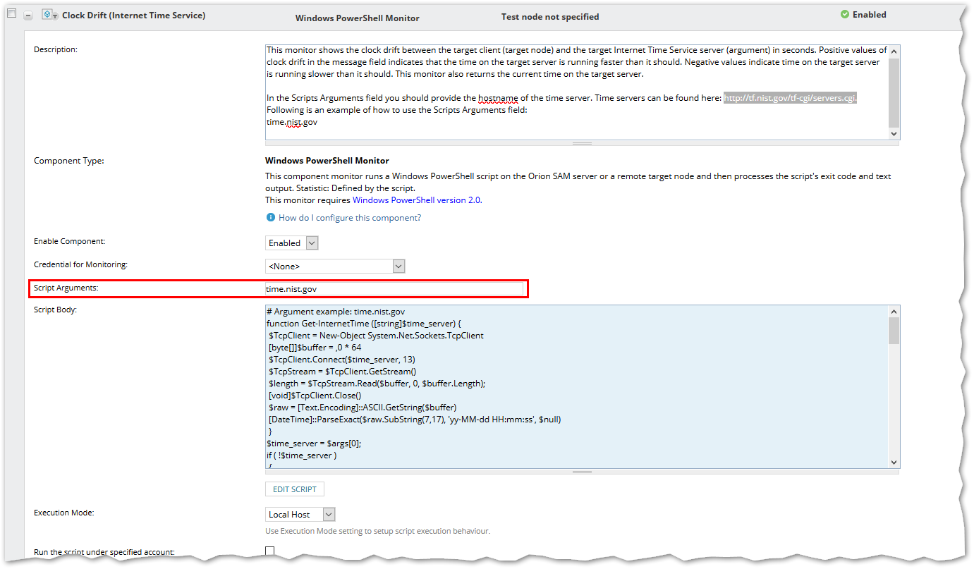

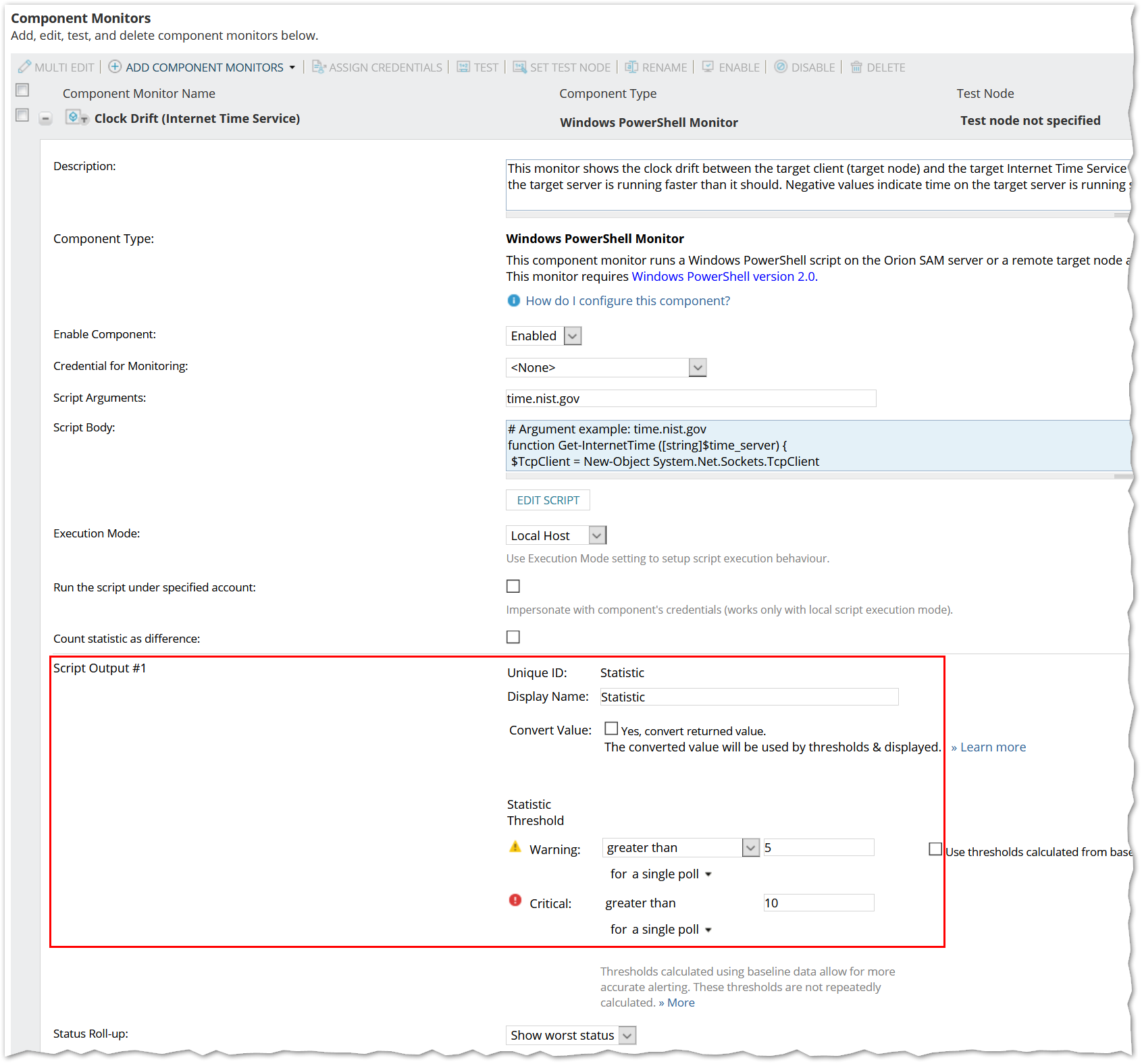

I'm using the default clock drift script, trying to figure out where to change enter the time.nist.gov server as the time server. I see the $time_server = $args, but when I place the time.nist.gov I get an error saying error in call method. I guess the easiest way to ask my questions is just where do I input the time settings for clock drift and where do I input the time.nist.gov server? Dumb question I know, but I a newb. Thank you.
Below is the unedited script. I also looked for the documentation, but the page where it was originally posted is blank.
# Argument example: time.nist.gov
