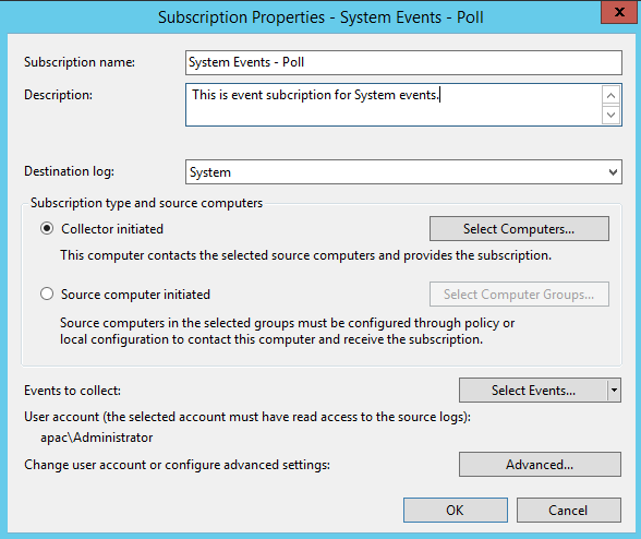

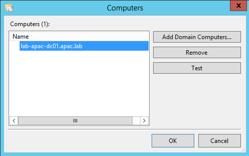

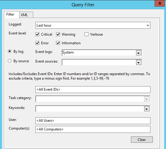

- Create Subscription - Collector Initiated
- Destination log would be recommended on the same Event Types (e.g: System)
| Header 1 | Header 2 |
- Event to collect: Query Filter - Last Hour - Event Level (anything OR all) - Event Logs: System
- Note: create other subscription for other event logs.

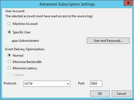

- Configure User Account with Event Log Readers.

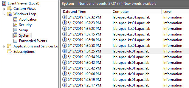

Verify Event Subscription works on Collector
- Look at System Events and look for events from Event Source computers.

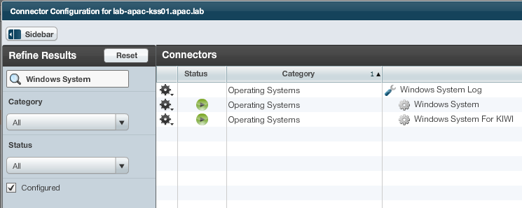

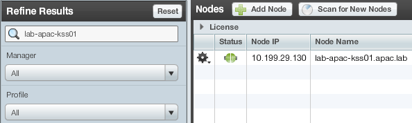

Setting up SEM Agent on Event Collector
- Configure Windows System Connector on Event Collector Server

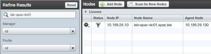

- Verify the Event Source Server in the SEM Nodes List (SEM Node License is required)
