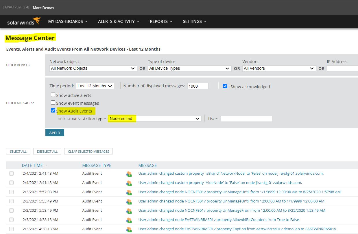

If I understood your question properly, this is what you are looking for.
1. Alerts & Activity -> Message Center, When a node is added and they forget to add the group name value on custom property that you have created, it will appear under Audit Events.
It would look like this -> User Admin/Username changed custom property 'GroupName' to '' on node ABCXYZ
" -> means that value is not filled and that field was left empty/blank.
If value for the custom property is filled then it would look like -> User Admin/Username changed custom property 'GroupName' to 'Network/Switch/Whatever' on node ABCXYZ

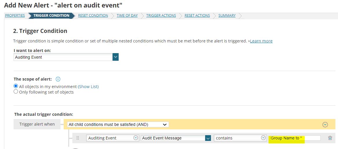

2. How to create an Alert on a Audit Event is mentioned in the below link:
https://support.solarwinds.com/SuccessCenter/s/article/Alert-on-Orion-Audit?language=en_US
3. Sample test alert will look like what's mentioned below, suite yourself and make the necessary changes to the trigger condition as required.
Hope it helps.
