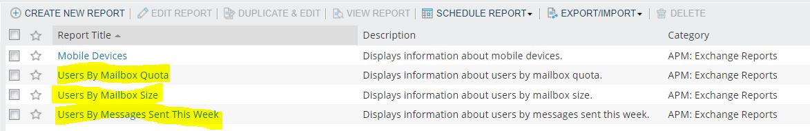

2. You already have 3 default reports under managed reports which you can use (have a look at it):
