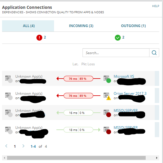

So i am unsure how to troubleshoot this issue. or even what the application connections are.
thanks in advance for your help.

So each is a virtual machine on a different box, there are 10Gig links between each box and connected to a Nexus switch. do you think it will be the physical connections. I thought that maybe there is a metric that is dropping traffic if it goes over a counter?

Could someone tell me specifically what this is measuring? Is it just TCP traffic being sent from the node to the application?
