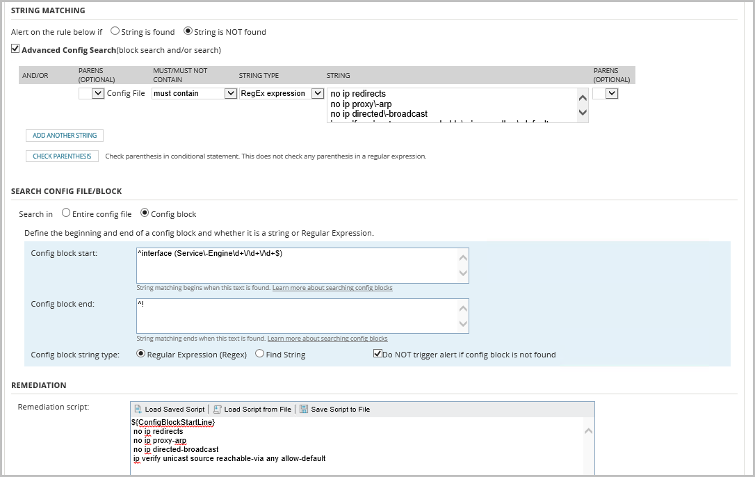

Does anyone know how to write regex for Cisco Interfaces, I have 500+ devices to do this to.
If the commands (no ip redirects, no ip proxy-arp, ip verify...) are not on the interface, I want these commands applied on all interfaces that are not shutdown (if too difficult, than apply the commands to all interfaces). Thanks!

POLICY REPORTS
Alert on Rule: if string is not found
Regular Expression:???
no ip redirects
no ip proxy\-arp
no ip directed\-broadcast
ip verify unicast source reachable\-via any allow\-default
Block Start: ???
^interface (Serial|.*Ethernet\d+\/\d+\/\d+$)
Block End: ???
Remediation Script: ????
${ConfigBlockStartLine}
no ip redirects
no ip proxy-arp
no ip directed-broadcast
ip verify unicast source reachable-via any allow-default
