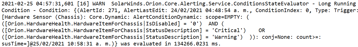

I upgraded my enviroment Orion Plattform 2020.2 without Hotfix to 2020.2.1 HF 2 and all the other products because i knew that there are some vulnerable products , after that i made the upgrade, all my alerts had a delay. when the nodes or components are alerted, i can see that those alerts are activated in "All active alerts" 5 - 10 minutes after, then the application sends the emails 10 - 20 minutes after that they were activated. Sometimes when the alerts are reseted, i receive the email 20 - 30 minutes afer.
I created i case with technical support but we havent made a lot. Is here anyone that has the same issue or similar? What could I do?
