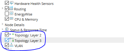

For clarification, this is the list of resources generated when you select 'List Resources' in the manage nodes section.
And by checking interfaces I mean, specifically these three
