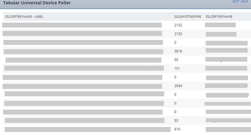

Recently, we added the UnDP "sslDaysToExpire" (OID 1.3.6.1.4.1.5951.4.1.1.56.1.1.5) and the UnDP "sslCertKeyName" (OID: 1.3.6.1.4.1.5951.4.1.1.56.1.1.1) to know when the SSL certificate of our Netscalers expire directly in NPM.
The info is shown in a widget (Tabular Universal Device Poller) of each Node like so:

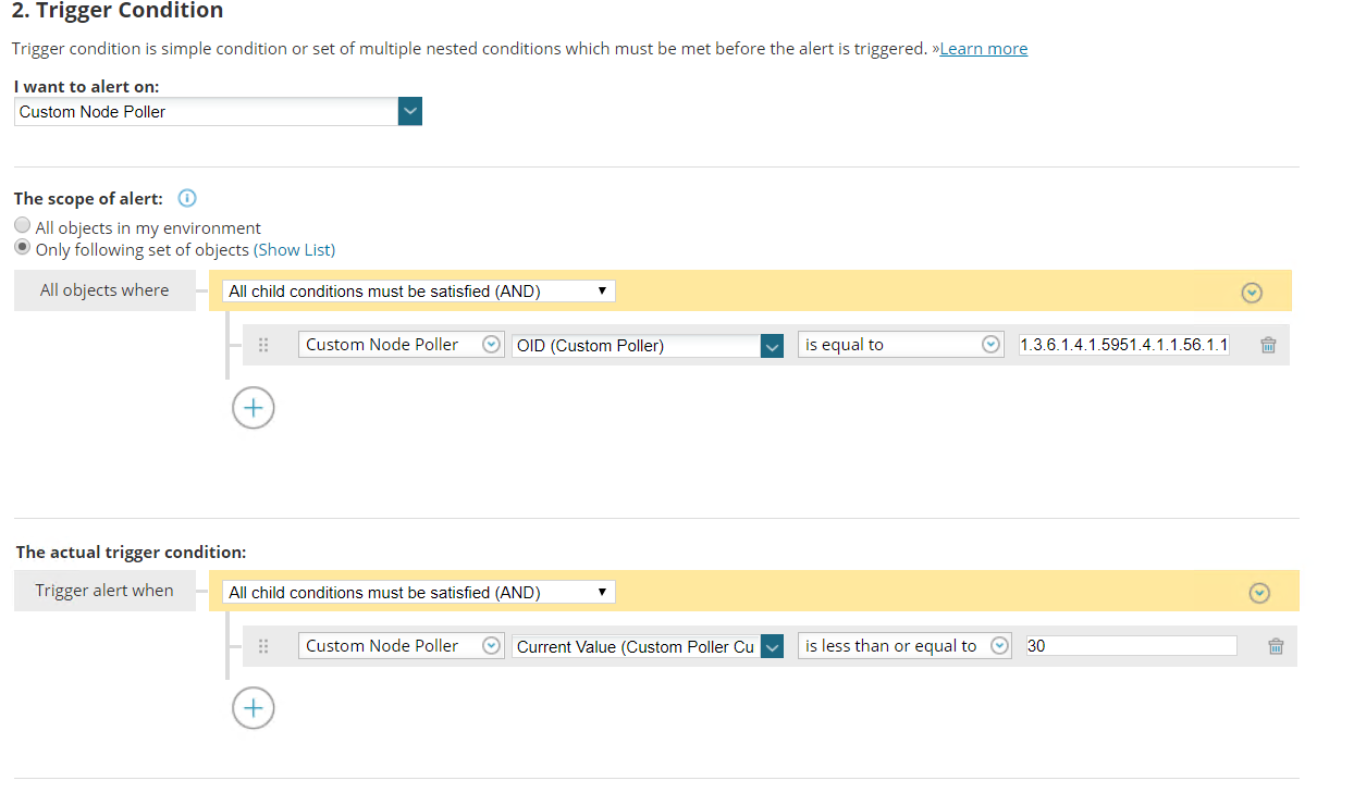

Now, I want to create an Alert to send and email when the UnDP sslCertKeyName Current Value is at 30 or less. here is how I configured the Alert :
The problem is: the alert is not working. It is supposed to trigger for at least 5 certificate (the ones that have 0 days to expire).
What I am doing wrong ? Can we created an Alert based on an UnDP value ?
