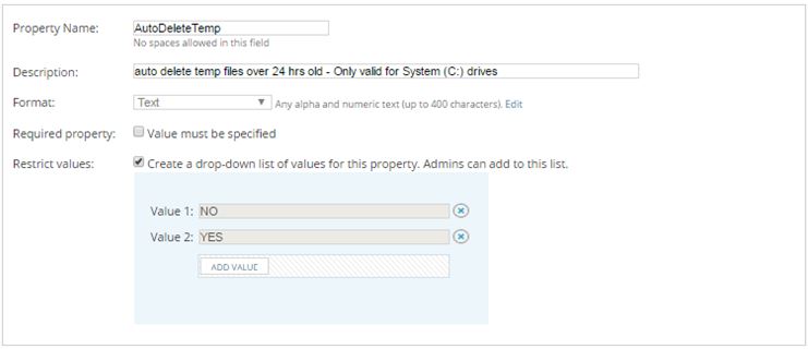

1 - Creating custom field on volume
Go to ‘Manage Custom Properties’ (/Orion/Admin/CPE/Default.aspx) and click ‘add custom property’. Select type of ‘volume’ and hit ‘next’.
Give it a property name of something meaningful such as ‘AutoDeleteTemp’, give it a description and select the format of ‘text’. Tick ‘restrict values’ and enter the values ‘NO’ and ‘YES’
Click ‘next’. On this page select ‘YES’ from the drop-down and then click ‘select volumes’.
Select ‘caption’ for the ‘group by’ field and in the ‘search for’ field enter “C:” and hit enter. Assuming you are using default captions you will see all your system drives. Select all and push them to the right-hand pane and click ‘select volumes’. Select ‘Submit’.
Snags: The only snag I had at this stage was that I initially used boolean values but this gave no ability to auto populate the field because all you can watch for is a ‘no’ value which could be either a new drive or someone has intentionally set it to no so this wasn’t good enough. Using a text field with yes/no pre-selections means that we can populate any system drives with a null value because if intentionally set it will be ‘no’ not null.

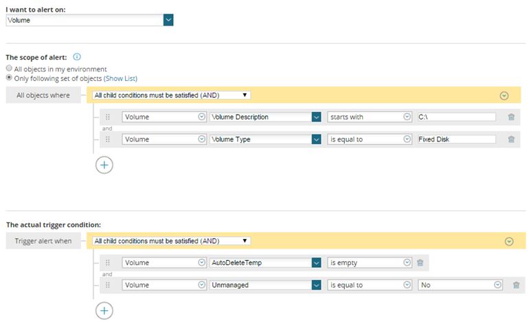

2 - Creating alert to populate custom field
Go to ‘Manage Alerts’ (/Orion/Alerts/#) and click ‘add new alert’.
Give the alert a meaningful name and description, set it to evaluate trigger every 6 or 12 hours and give it a severity of ‘informational’ so it’s clear there is not problem. Click ‘next’.
Select to alert on ‘volume’.
For the scope use ‘volume->volume description->starts with->C:\ AND volume->volume type->is equal to->fixed disk’.
For the trigger use ‘volume->AutoDeleteTemp->is empty AND volume->unmanaged->is equal to->No’ (see snags below for reason for the latter).
Click ‘next’
Select ‘reset this alert automatically after’ and give it a reset time of 30 seconds. Click ‘next’ and ‘next’.
