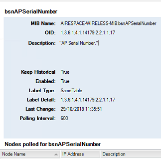

I have been fortunate enough to find the OID shown below that I have now assigned to the 12 Cisco 5500 Series WLCs via the UnDP App on the Main Poller.
MIB Name: AIRSPACE-WIRELESS-MIB: bsnAPSerialNumber
OID: 1.3.6.1.4.1.14179.2.2.1.1.17
Description: "AP Serial Number."
When testing this OID against each of the WLCs, there was the full List of the Thin [Light Weight] Access Points that are connected to the WLC Shown with their Serial Number.
