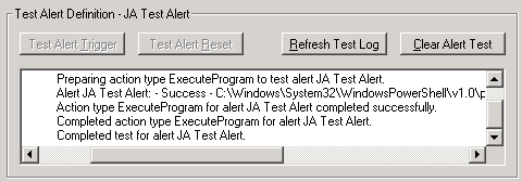

I verified that local service had write access to the temp folder, and the file mentioned, I even used psexec to launch a command prompt as the local service account, and tested execution. When I trigger a test of the alert, it writes that the action was successful, and yet nothing was written to the temp file.
If I copy the line executed from the test log, and paste it into the same command prompt running in the service context, it works fine.
What am I missing? How can I enable more logging for the alert manager to see what's going on, because success isn't really true? Or am I just using the function incorrectly? Can we not pass arguments to executables?
