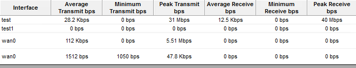

I am getting different values in report writer and web based report.
Could some one please explain why ??
e.g : In below snapshot Avg Transmit bps is quite different for test interface.
Thank you.
Prashant

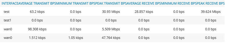

The difference is that the legacy Win32 report writer is rounding up. Web based reporting is showing the five most significant digits.
Thanks aLTeReGo, but why it is showing avg transmit bps as 28.2 kbps in report writer and 63.2 kbps in web based report for test interface, it is different on some other interface as well. Is it some database issue ?

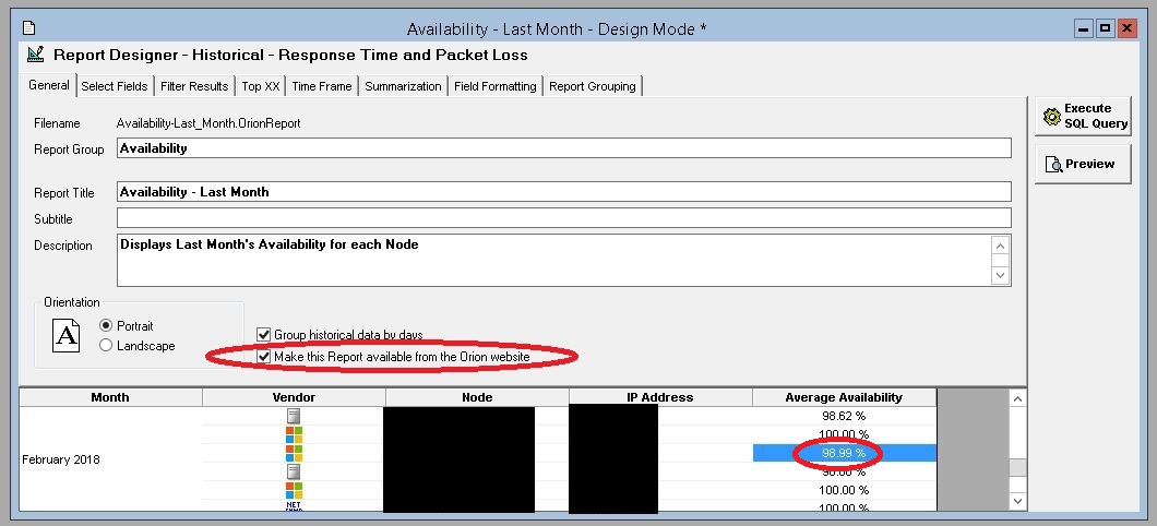

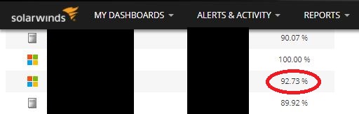

Just so you know, you're not going crazy. I too have also noticed this, but just recently. I have monthly availability reports being generated via SolarWinds and just so happened to notice that my percentages were off this month.
It turns out that when I run the Out-Of-The-Box "Availability - Last Month" report in Orion Report Writer and the EXACT SAME report from the web (since that option is checked on the report writers OOB report...) I get two completely different values. And they're not close enough count this as a rounding error.
See my screen shot below. This is the same server that shows in the exact same reports. One via the report writer and another via the web. Nothing at all has changed been modified with these reports. The 92.73% is the correct percentage as I know this server was down for a significant amount of time this month, enough to definitely not average 98.99% availability for the month.
I can view the SQL query being executed on the Report Writer report and the table that its referencing is the ResponseTime.Availability table. Unfortunately the web based version of this report does not allow me to view the SQL query being executed, but since its available in the web console specifically because it's made to be available from the report writer, they should both be making queries to the same table, or so I thought.
SELECT CONVERT(DateTime,
LTRIM(MONTH(DateTime)) + '/01/' + LTRIM(YEAR(DateTime)),
101) AS SummaryMonth,
Nodes.NodeID AS NodeID,
Nodes.VendorIcon AS Vendor_Icon,
Nodes.Caption AS NodeName,
Nodes.IP_Address AS IP_Address,
AVG(ResponseTime.Availability) AS AVERAGE_of_Availability
FROM
Nodes INNER JOIN ResponseTime ON (Nodes.NodeID = ResponseTime.NodeID)
WHERE
( DateTime BETWEEN 37954 AND 37983 )
GROUP BY CONVERT(DateTime, LTRIM(MONTH(DateTime)) + '/01/' + LTRIM(YEAR(DateTime)), 101),
Nodes.NodeID, Nodes.VendorIcon, Nodes.Caption, Nodes.IP_Address
ORDER BY SummaryMonth ASC, 4 ASC

That's a really good factor to incorporate, but unfortunately no. Our Orion server, and the SQL server housing the Orion DB, are both housed in the same data center that is located within the same timezone as the browser / machines we are using to run the reports.
Is there any way at all to view the SQL query being executed by the web-based report? The web report seems to be the one calculating the average correctly. I'm curious to see if there is a difference in query structure or calculation between the Report Writer and the Web-based report.
Yes, but it's viewable only in the log files when in debug mode. I recommend that you open a case with support so we can investigate the discrepancy and determine which report is accurate.
