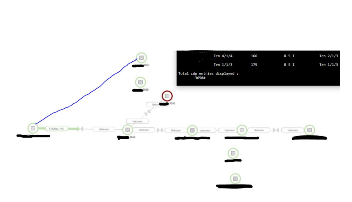

acesses browser out server.
acesses browser in server Orion.
Can I help me, to make show in all acesses. ???
