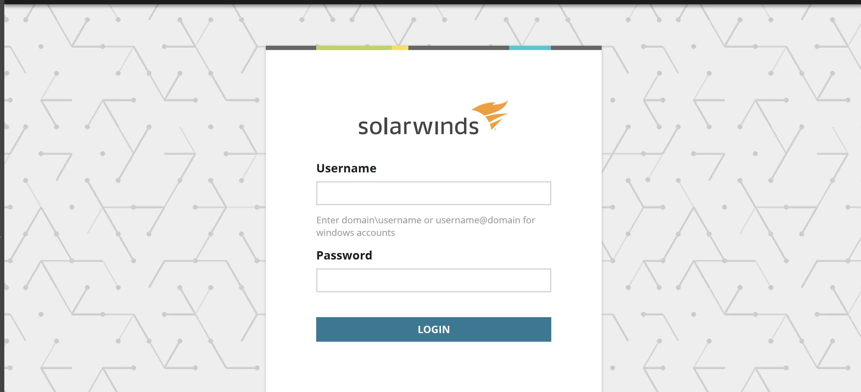

Thanks for suggestions. Do you have this working? I'm finding difficult to compose the URL correctly. Would this work?https://x.x.x.x/Orion/Interfaces/InterfaceDetails.aspx?NetObject=I:${N=SwisEntity;M=InterfaceID} Also, how do you get this alert to email the page without asking for a login? I've tried all the options but all my attachments come across like this:
You could navigate to the particular chart you want to email and use that as the URL and modify the NetObject= to the interfaceID variable.
To get past the login you may be able to enable DirectLink and utilize that for emailing it out without a login if that doesn't work
Success Center - Use DirectLink Account to Share Views with NonOrion Web Console Users
