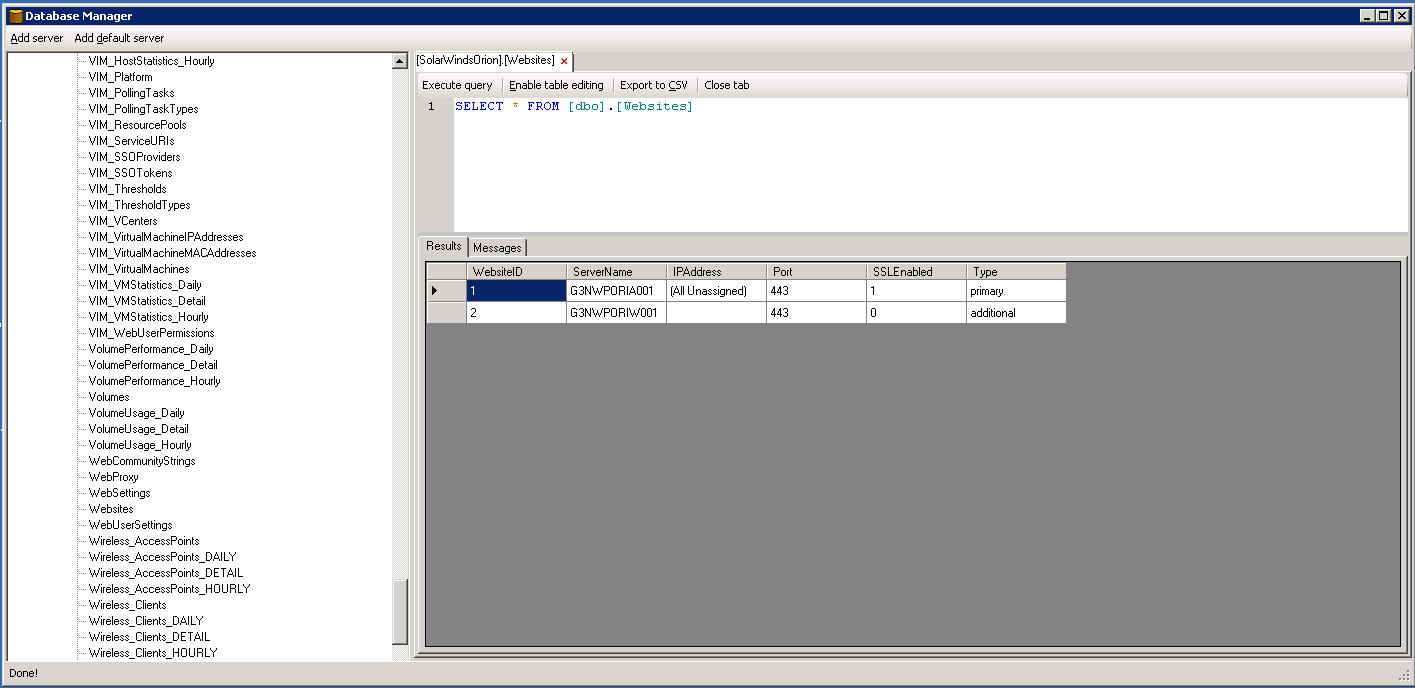

In an attempt to figure this out I ran a query against dbo.websites and found that the webserver is being labled as the additional polling engine in the database. I know this is incorrect and should show the secondary polling engine's name and IP instead of the web sevrer's information. How would we correct this issue?
