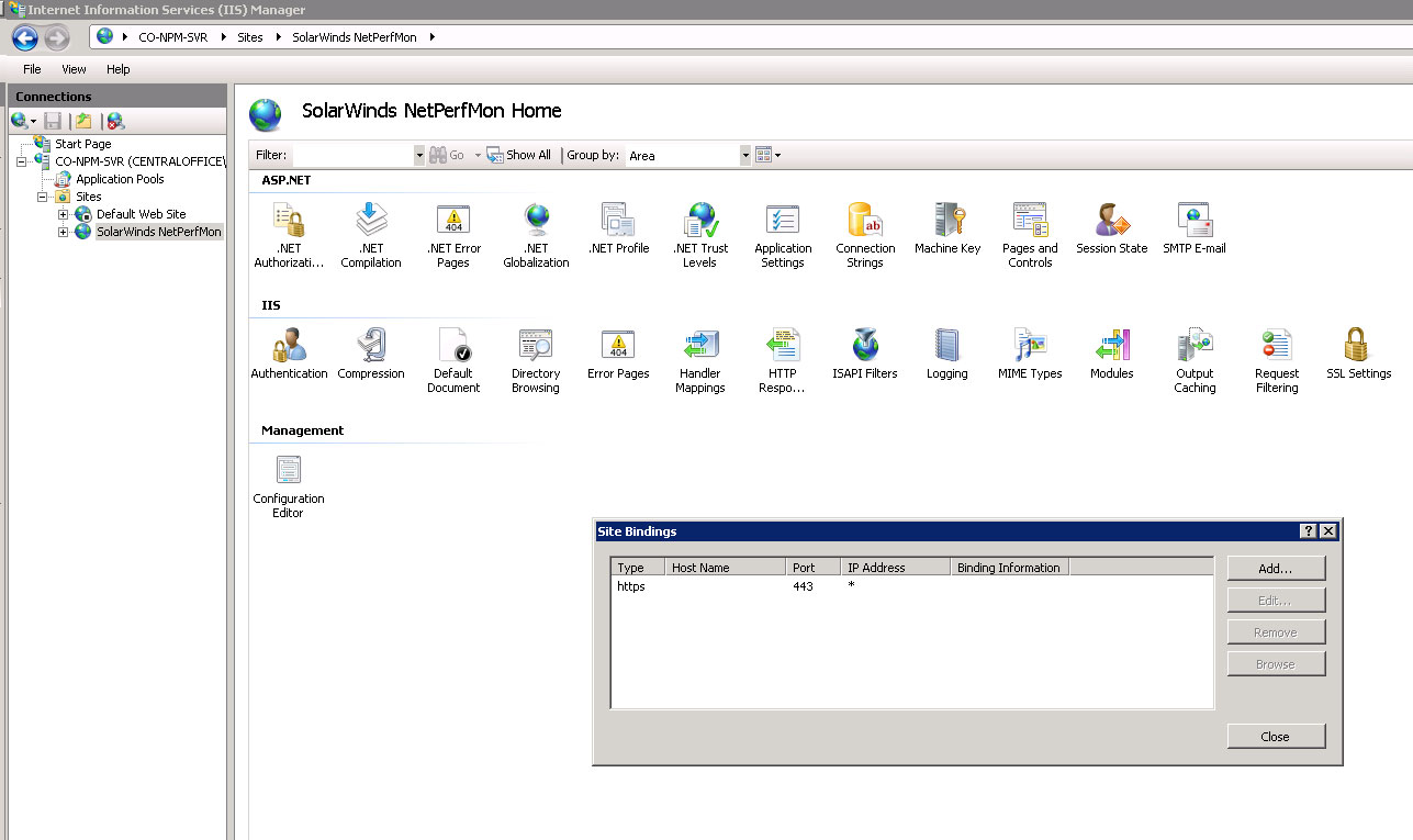

Can you show a screenshot of the bindings you have setup within IIS for the SolarWinds Orion website?

I used the certificate that the SolarWinds software created.
It is a self-signed cert.
