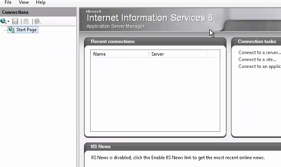

I checked the SSL binding on the IIS Server and also make sure that the Orion website is listening on all IP addresses as resolution from https://support.solarwinds.com/Success_Center/Network_Performance_Monitor_(NPM)/Unable_to_retrieve_URL_using_Excel_type and https://support.solarwinds.com/Success_Center/Network_Performance_Monitor_(NPM)/Unable_to_retrieve_the_PDF_CSV_or_URL_of_scheduled_reports given, I can confirmed the binding is already correct and IP address is set to All Unassigned with port 443.
