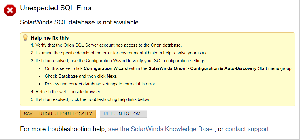

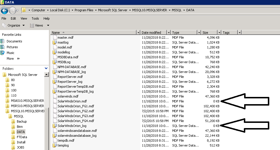

after doing some maintenance on the system , database is corruption and Orion not working , in database folder \Data\SolarWindsOrion.mdf Log\SolarWindsOrion_log.ldf both is 0 kb size .

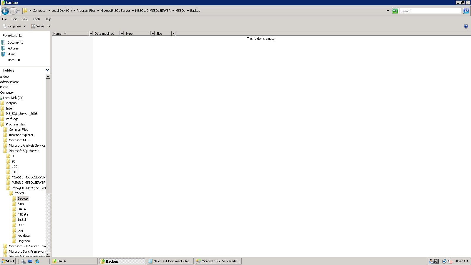

Ok, if you go back a directory to C:\Program Files\Microsoft SQL Server\MSSQL10.MSSSQLSERVER\MSSQL - There should be a folder called Backup, is there any files in there? Even if they are older files you might be able to get some data back up and running?
The other question is, what are the other two SolarWinds MDF files in your image?
one called solarwinds.mdf and one called solarwindssamdatabase.mdf ??
thanks a lot for caring and reply
