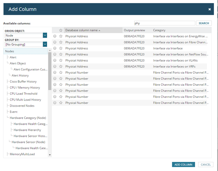

Create a new report with a table, when it asks for the datasource select Interfaces and use the advanced selector to find the interface traffic history table and look for total bytes, then set that to = 0. Now it will grab every timestamp where total bytes was 0.
On the section where you pick the columns you want I would just use interface FullName and Interface Traffic History/Timestamp

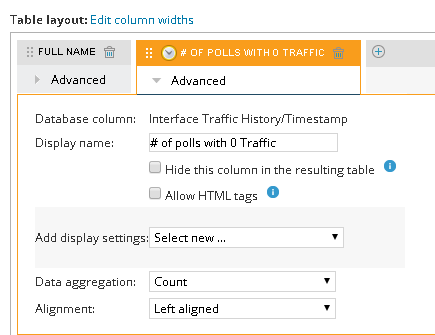

Change the Data Aggregation field to a count, and rename it so it makes more sense, I used # of polls with 0 traffic.
This is what you get
So in my environment I know that interfaces are polled every 9 minutes, so I could ball park that and say this interface had 0 traffic for 1713*9/60/24=10.7 days out of the last 30. In SQL I would probably just convert this figure to a percent and have the report look up the polling interval of each interface and calculate this all for me so I don't have to use my brain but you wouldn't be able to pull that off using the GUI.
