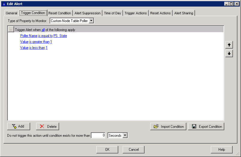

MY ALERT is a follows; (Ignore the Nodes.Maintenance part; as that is just suppression based on a date/time custom property input)
WHERE
(Nodes.Region <> 'Emergency Gear Online') AND
(CustomPollers.UniqueName = 'PS_State') AND
(CustomPollerStatus.Status <> '1')
) AND
(Nodes.Maintenance_Start_Time > getdate()) OR
(Nodes.Maintenance_End_Time < getdate())
OR
(Nodes.Maintenance_Start_Time IS NULL) AND
(Nodes.Maintenance_End_Time IS NULL)

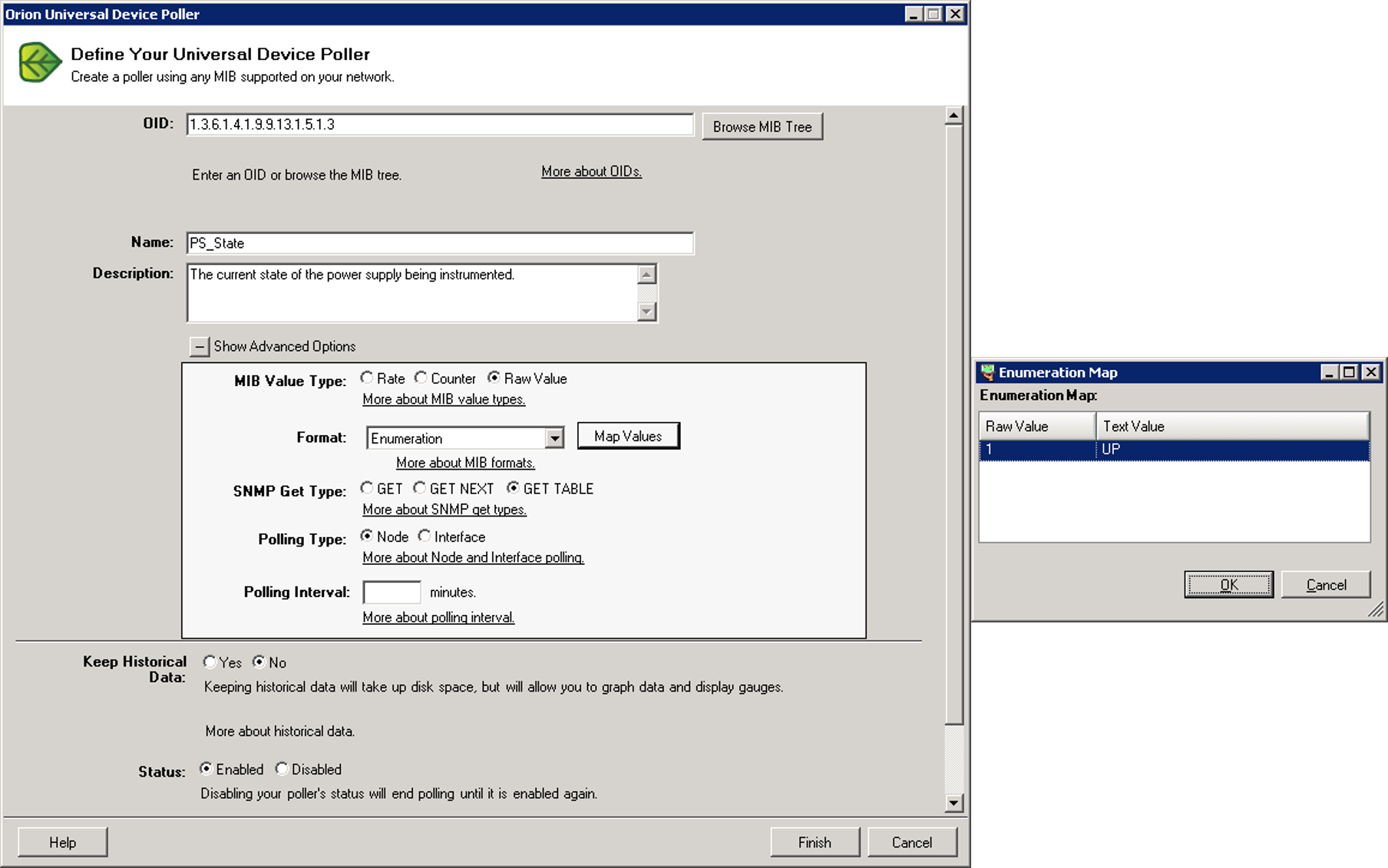

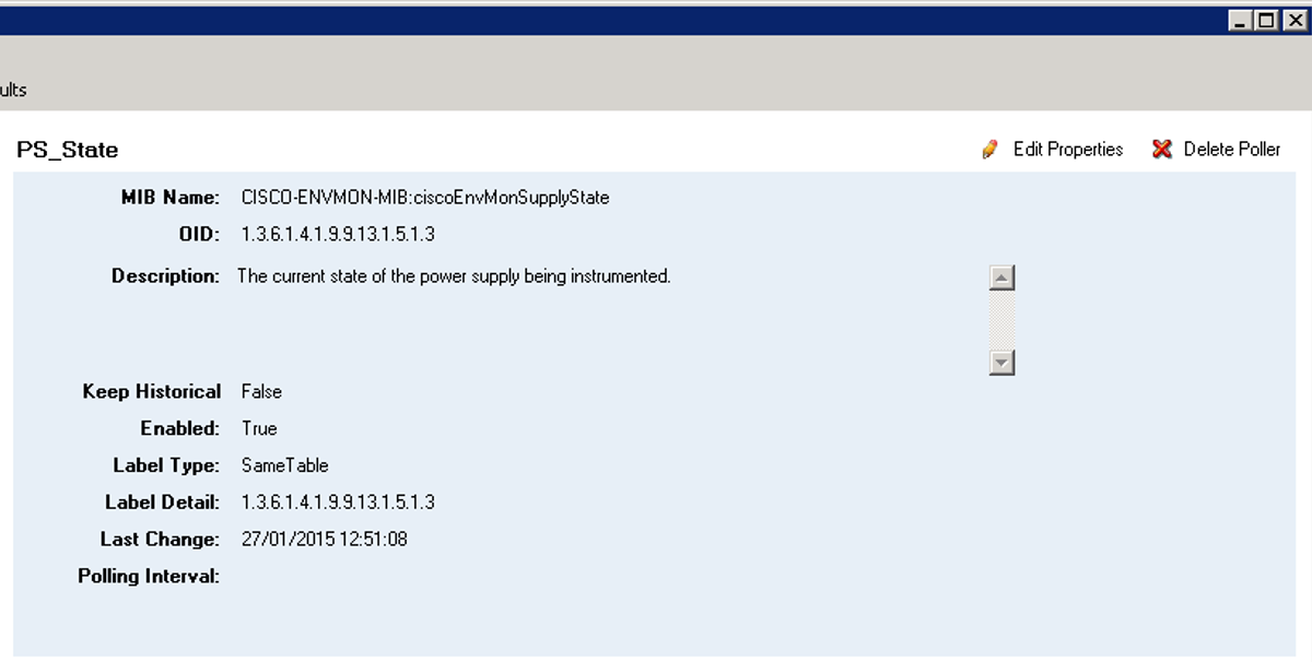

The OID tables that I am using is
1.3.6.1.4.1.9.9.13.1.5.1.3 = State (Numeric Value)
1.3.6.1.4.1.9.9.13.1.5.1.2 = Status (Descriptive Text Value)
