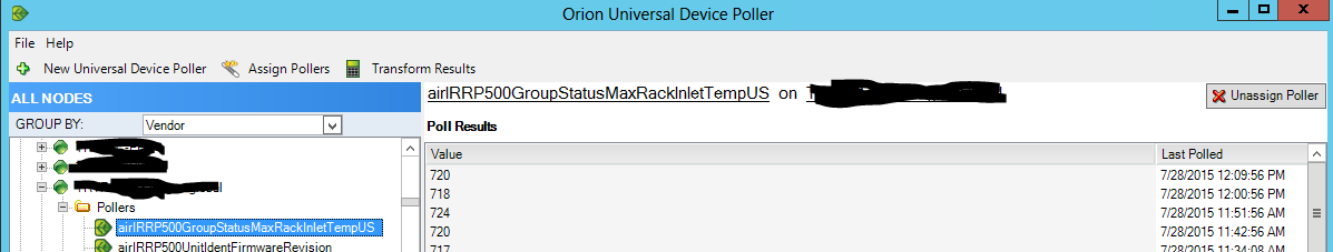

3.) In Orion Universal Device Poller, I see that OID's that have been assigned for years are collecting stats, and Orion can tell the 'Vendor' as American Power Conversion Corp, and Fortinet.

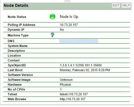

4.) In the generic view, under Machine Type, it shows the Vendor Icon, but Unknown.
5.) When I check one of our other instances that is at version 11.5.2, but has NOT yet applied Hotfix 1 or 2, Fortinet for machine type is showing up correctly.

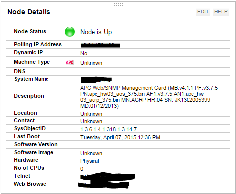

For example, here's what we see for the APC airIRRP500Series on the Hotfix 2 for a couple of our instances.
Since this issue is consistent across both specific model types, for the same 'Unknown' status for Machine type, but all the OID's assigned are polling fine, but NOT showing up in Orions 'Views by Device Type' list anymore, my hunch was it was something to do with the NPM NPM Hotfix 1 and 2 upgrades messing it up.

Message was edited by: Doug HilbertI just verified that 2 of our other instances which are at same NPM version 11.5.2, but DID NOT get the NPM core HOTFIX 1 or 2, are correctly reporting Fortinet correctly for Machine type, so I've opened a ticket with Solar Winds.
