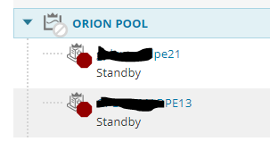

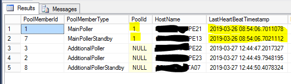

Both nodes from the same Pool got outdated on their heartbeats by unknown reason:
So, you see this on the HA Summary

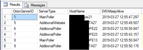

Obviously both machine are healthy as shown on [OrionServers] table.

When KeepAlives got outdated can be forced restarting the SWA Service but doesnt work for HA. Even restarting everything hasn't work on the PE21 so, i'm stuck. ¿do you know any trick to force the update?
