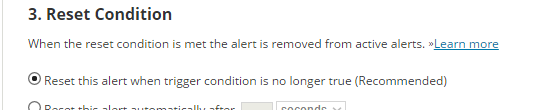

Screenshots of current example alert:
Do I need to change the reset condition to custom and reset when status is equal to up?
