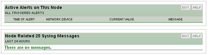

When selecting a node, in that particular view you can add in the "Active Alers on This Node" resource. Or the "Node Releated 25 Syslog Messages".
What I need to be able to find is all the alerts that are configured for a given node, not what is currently active on it. Thanks.
