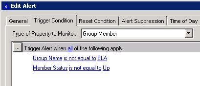

this should be possible, create an advanced alert and select "group member" property in trigger section.
as trigger you define something like:
this would trigger you an alert for any defined group member, but not for group BLA - test it, I never did the kind of reverse alert you described...
