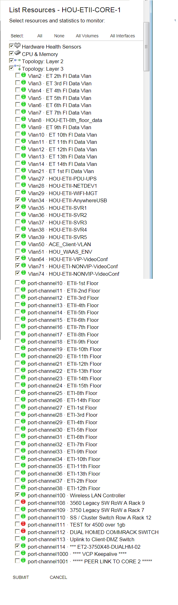

1. I have NPM 10.4.2, I go into my nexus 7010 > List Resource > I only see about 166 interfaces (vlan & port-channel, no ethernet interfaces), I have around 300 interfaces (port-channels, vlans, ethernet) on my switch. How can I see the rest of the interfaces so I can put a check on it, to monitor it? I do not see any ethernet interfaces.
I believe it was working before the upgrade, bc we have ethernet 10/19 monitored, but we disconnected the device and added another device to etherent 10/20. Now when I go to list resources I dont see any interface to un-monitored or monitor.
On list resources I only see 166 interfaces. (I cropped the vlans out that was in the middle). None of the ethernet intervaces are seen.

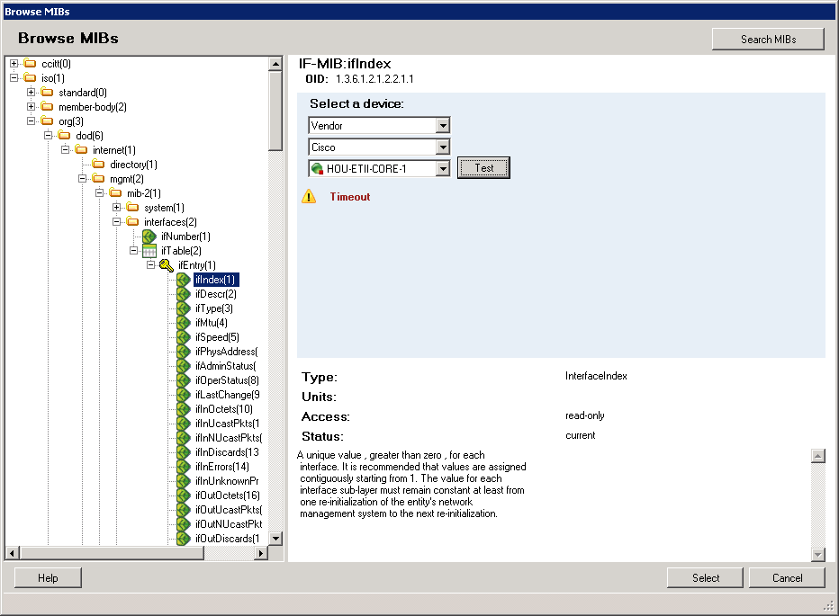

Testing ifindex and ifDescr on the 7010 timesout in MIB Browser. Is there a way to change the timeout settings, maybe there are too many interfaces so it needs more time to run?

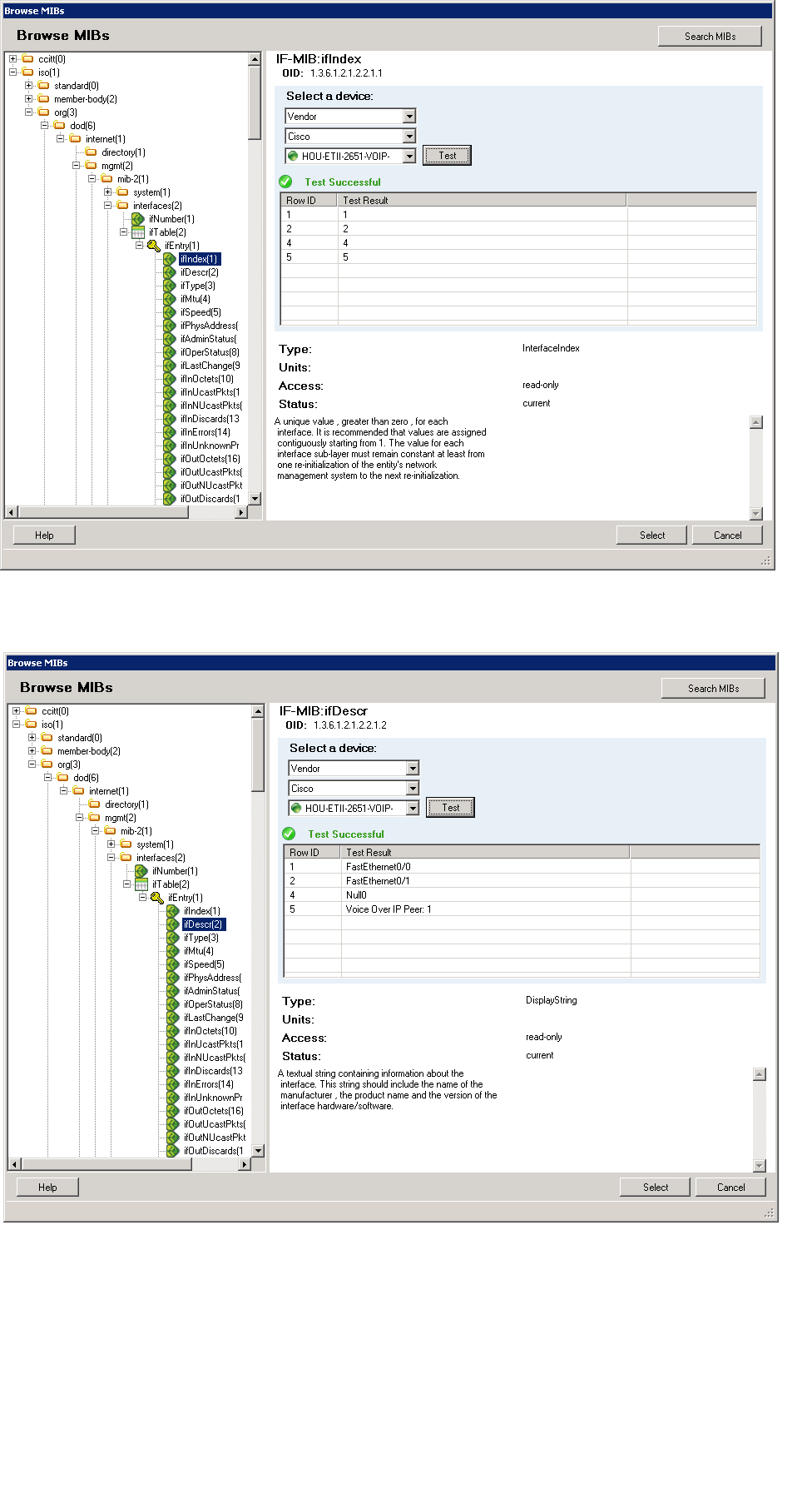

Print screen of other devices that can see all the interfaces (ifindex and ifDescr) .
