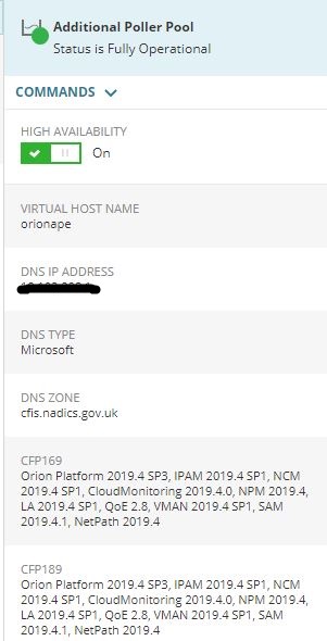

When I try to re-activate my HA Pools, i can re-enable the Additional Poller Pool, however i cannot re-enable my Main Poller Pool due to difference in software versions between Pollers (see Below)
As you can see my Primary Main Poller appears to have a different version of CloudMonitoring Installed to the others, but the same executable was applied on all servers.
How can i resolve this issue, so that all servers have the same software version to get my HA solution back to full working order.
