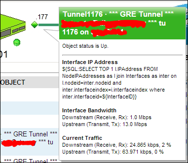

I have used it in Map ToolTips for the interface and it didn't return IP address:
Hello alexslv,
Unfortunately Map tooltips doesn't support SQL variable. For this please create feature request.
For Alert message this should be work
Lada

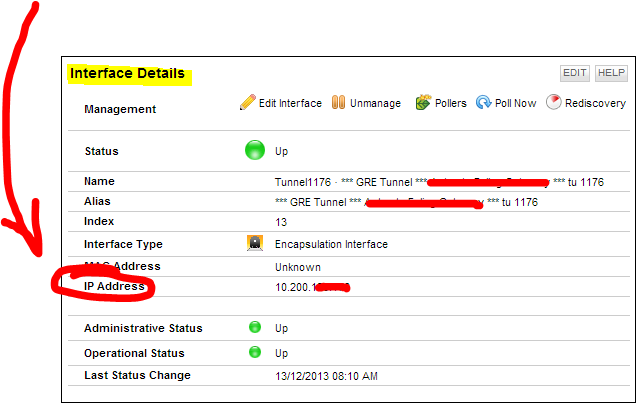

${IP_Address} Node IP address, It is Node ip adress not Interface IP adress.
What we need is something like ${InterfaceIP} in:
