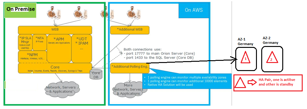

I have a requirement to setup the APE in AWS to monitor the devices located in AWS.
We have main orion servers and DB on-premise and additional APE will be deployed in AWS.
Below is a high level architecture to be used.
Question is that how the HA APE can be deployed in the AWS? If our main Orion on-premise is located in Germany, then:
1. Does it mean that we can deploy the Additional APE only in Germany AWS to sync with main Orion? or On -premise can also monitor the devices of other region (e.g. US) using the additional poller in US and Main orion in Germany.
2. For the APE deployment in AWS - As this will be in HA> do we need to deploy the HA pair in same Availability zone of AWS or it can be deployed in different availability zone and HA can be achieved?
