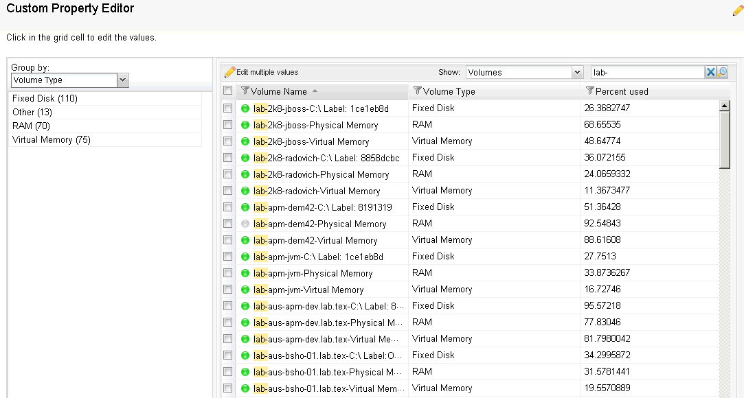

I'm sorry to hear about your frustration. We definitely made some mistakes with migrating the Custom Property Editor to the web. We've been working hard based on feedback late during the RC to bring this functionality to the web. We are currently in RC phase for a service release (10.4.1) to address these concerns. The RC is available in your customer portal and I encourage you to install it and provide your feedback. I will be doing a blog post soon with more details and screenshots describing these new changes. In the meantime, here is a quick screenshot of managing volume in the web.

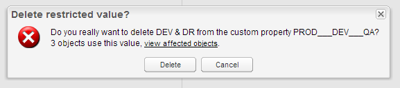

I have been spending more time trying to find work-arounds than I have actually making successful changes and adds to the CPE. Importing and exporting in an Excel spreadsheet is a great way to do things but we have moved past 1995 so it would be a great if SolarWinds would also advance. When I click on the view affected objects link it takes me to the manage node properties page but no where close to the 3 objects referred to in the message. How is this useful?
