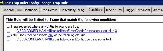

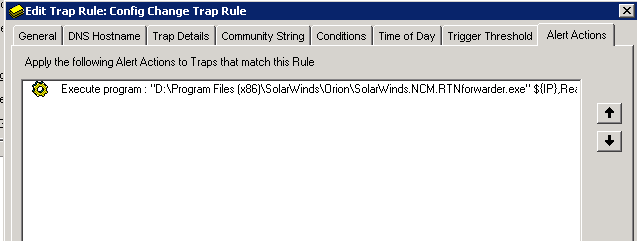

Is there a way to use "SOLARWINDS-TRAPS.10=4.2.2.2" info to execute the alert action path "Orion\SolarWinds.NCM.RTNforwarder.exe" ${IP},RealtimeNotification,${DateTime}.${Message}" - I believe the $IP relates to the ip address where the syslog/trap is received, in this case the DMZ server and not from device itself. It makes sense to me why RealTimeChangeNotification is not working.
This is exactly what i see from my trap viewer except for the tampered ips.
This is the condition i set prior to the DMZ setup, which i can say works totally fine.
