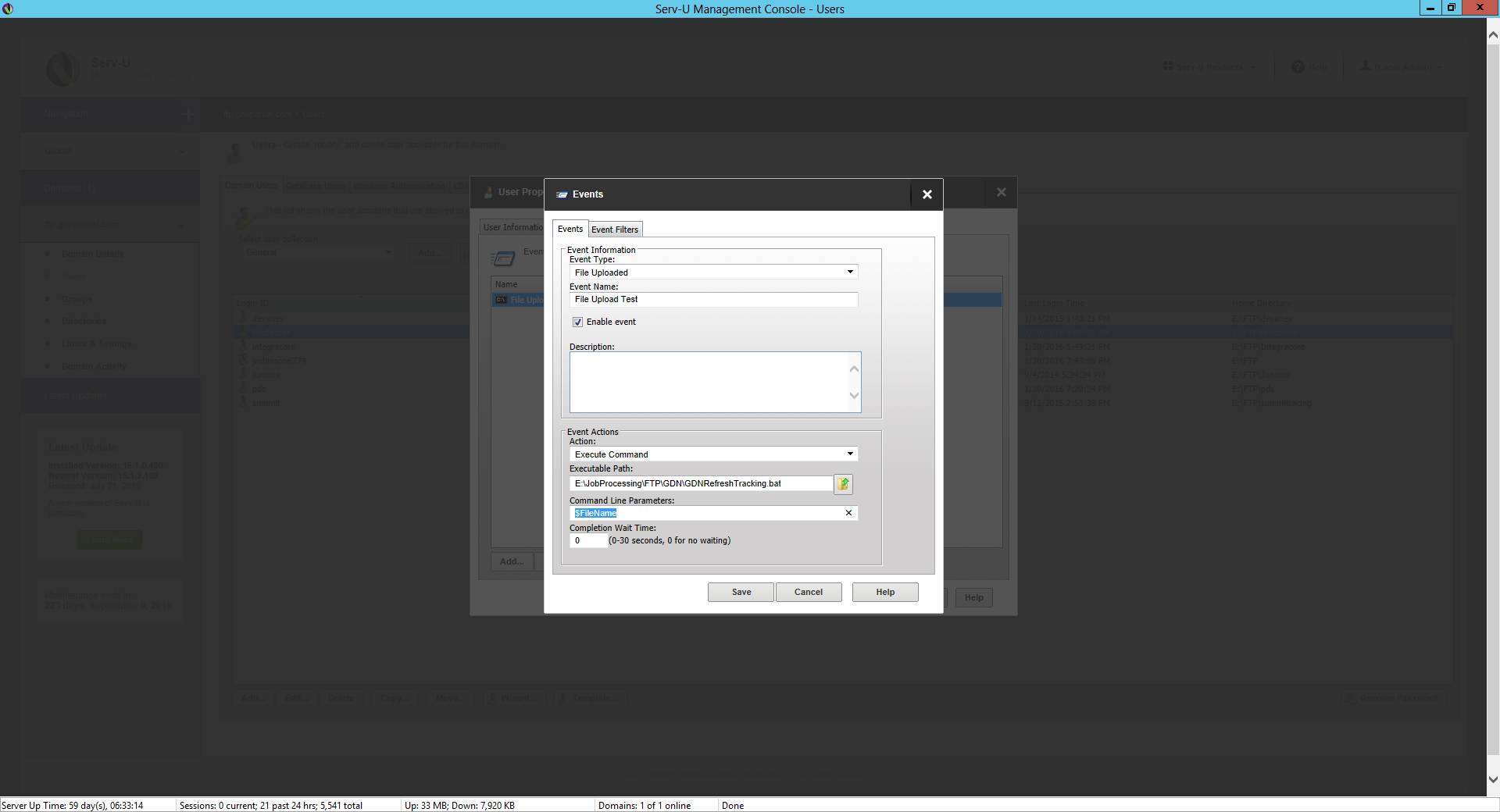

I'm trying to pass a file name to a windows batch file after the file is successfully uploaded to the FTP server. I'm able to execute the batch file without any problems just don't know how the pass the name.

All of the Serv-U settings are correct, I just needed to use %1 in my batch file to retreive the filename. Example:
echo %1 > filename.txt
