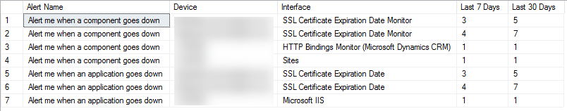

I'm good with the alerts that I currently receive and it works as it should, but I'd like to get a report based on these alerts, that counts the number of times the interface triggered the alert in the past.
The report(s) should display the number of occurrences for this alert this week, this month, last week and last month.
I'm having trouble building one such report or Custom Table resource based on SQL/SWQL. I've even tried basing the report off Events that the Alert creates. No luck so far. It either doesn't work or the count is way off. It might be due to the way historical alerts/events are stored. It may even be due to an issue with timestamps and alerts/events? I'm hoping I can get some help with this here.

What I have so far is based on zackm's work posted here: Alert Triggered
